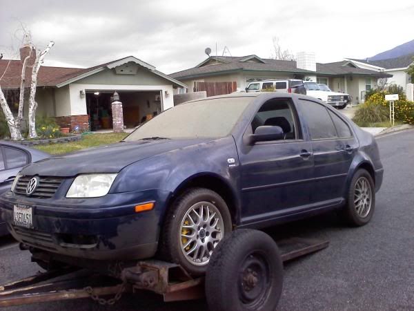

yo whats up fellas new to dubs but always been my favorite cars and i was finally able to buy one
i picked this one up super cheap only 500 dollars
guy said it threw out black smoke so he thought it was the head gasket and tried working on it and eventually just bought a new car
here is a pic sorry i don't own a camera just a phone
2001 wolfsburg jetta 1.8T 154k i know its a lot he used to drive to work to Anaheim from San Bernardino but the car is in awesome shape interior and exterior
what do you guys think?

lol i know that dirt makes her look ugly but shes really clean no dents she been gathering dust in the garage since 2008 when she broke down
the bumpers not on right either had to come of to load it on the dolly

gonna try and get her started this week im pretty sure its not the head gasket that would have yielded bluish white smoke the guy said black smoke and no power... im thinking maf sensor or boost leak any ideas?

Nice find. Black smoke is raw fuel. Since the guy has no clue about what went wrong I would definitly get her running to see for yourself what's wrong. Charge the battery from sitting and pull the spark plugs. Once plugs are out go ahead and toss some oil maybe around a tablespoon into each cylinder to build up lost compression. Inspect your plugs for blackness since that is a sign of running rich which is what the guy said he saw from the tailpipe.
If black smoke is really what's going on it will be a fuel issue and it sounds like your on track. Maf, injector, o2, etc. Be sure to scan the car to aid in diag
