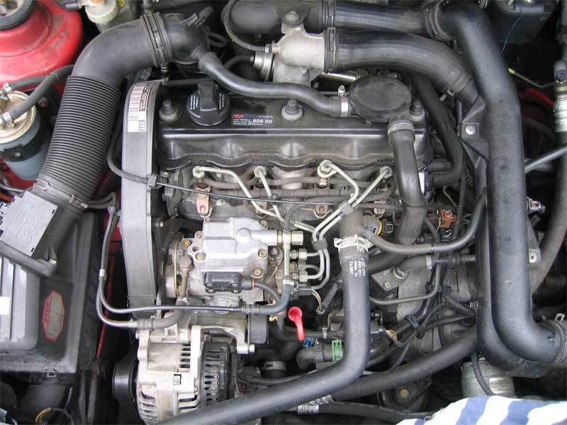

Here is the engine:
The CCV is the disc looking thing ontop of the engine at the right with a hose going to the left and a hose going down the front of the engine.
The hose coming from the CCV to the left across the top of the engine goes straight into the Air Intake.
Hot CCV gases enter the intake's cold air, after the Airfilter and MAF but before the Turbo inlet.
When the Hot CCV Gasses meet the Cold Air condensation occurs and the oil and soot start coating the turbo inlet, the turbo inlet chamber, then all the piping to to the inter-cooler... the inter-cooler then condenses the rest of the Oil and soot from the vapours. The inter-cooler is a very efficient oil air Separator... BUT I don't want it to ba a Catch Can.

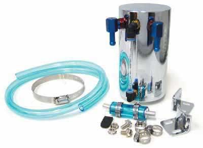

Here is the catch can:
Fittings for Inlet and outlet, fluid level sight gauge, and on the bottom a screw plug for draining fluids.
Connecting ip up is pretty simple... You just disconnect the CCV hose to the air intake and add the kit.

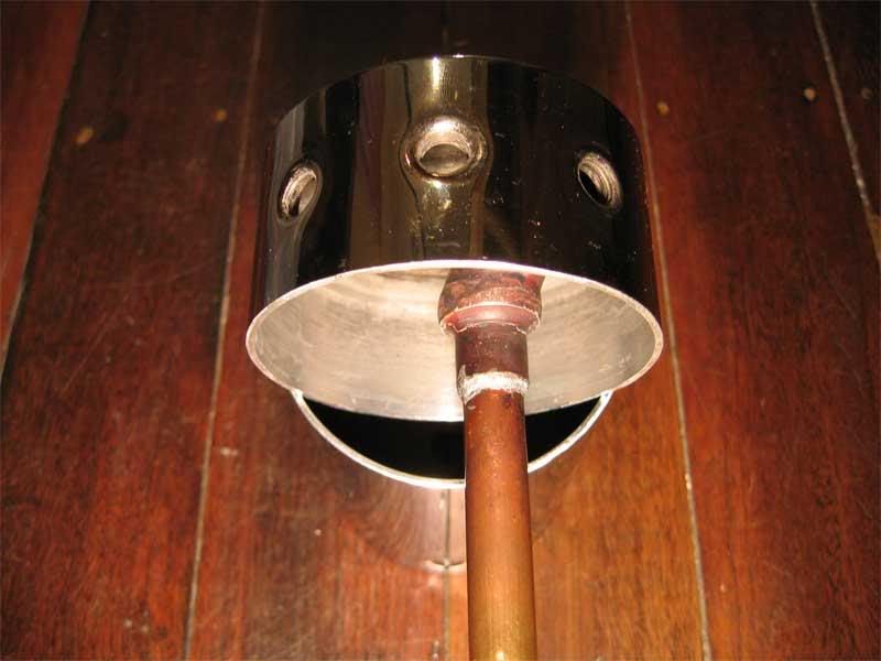

There are no baffles inside... so I made one! Baffles are good. If you don't want to spend $$$ on a can with baffles make the baffles!

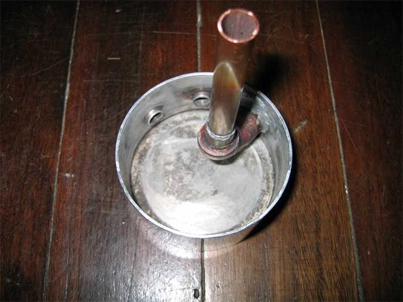

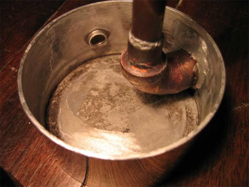

So what I did was cut my can in 2, and braze a copper angle and pipe around one of the holes... this is now my inlet hole!!!
The design is to force the air to the bottom of the can where it will pass more SS Wool and be extracted.

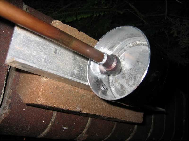

How I welded Aluminium and Copper:
I bought some of those Aluminium welding rods from the Home Show years ago.
Back then I could not get the rods to work correctly with my primus torch back then... the job was melting before the rods!
So I searched on the net a found a site that had some videos of using a similar rod to weld and repair aluminium.
I came to the conclusion that I did not have a direct enough heat source.... so I went out and bought a portable MAPP torch.
I did a little net surfing on welding dissimilar metals as that is what I'm doing.
I could not find any site of FAQ or Forum that has a method for welding 2 different metals like Copper and Aluminium.
Most of the sites said you just don't do it as there is no need for it in plumbing or tank fabrication. The join would fail under stress from movement or pressure.
Brazing the parts together with plumbers brass rods will not work.
Lead Soldering was an option as the pipe was not under stress or under pressure.
Tig Welding... I don't think so!
Because these Aluminium welding rods can weld non ferrous metals... so I thought copper and Aluminium should be ok.
Here is proof!
Bit untidy... but it worked and it is so strong. the copper pipe was flexing when I tested to see how strong the weld was!
Some closeups...

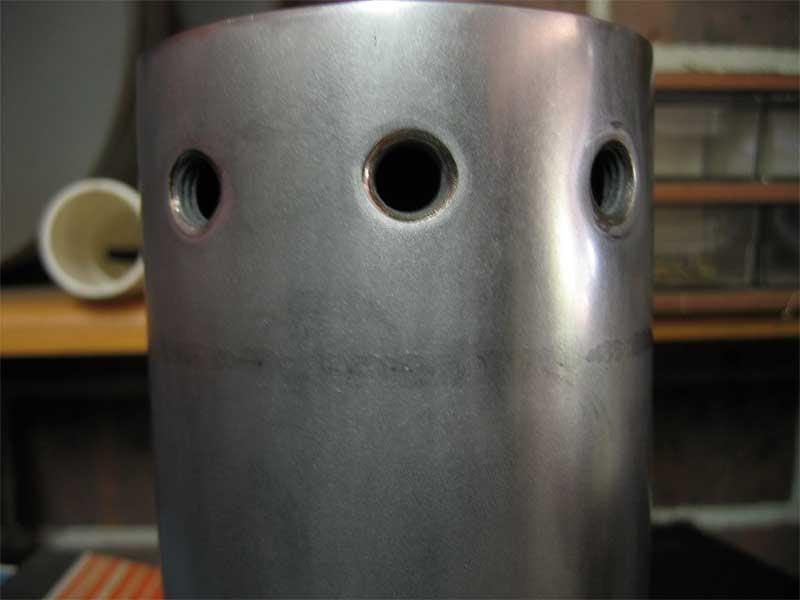

The Center hole is for the fluid level sight gauge.
The copper pipe comes to about 2cm from the bottom of the can.

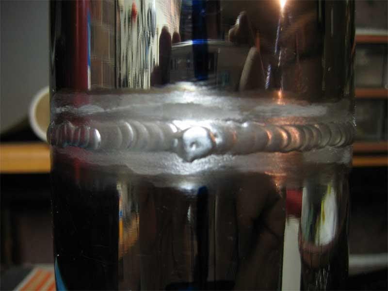

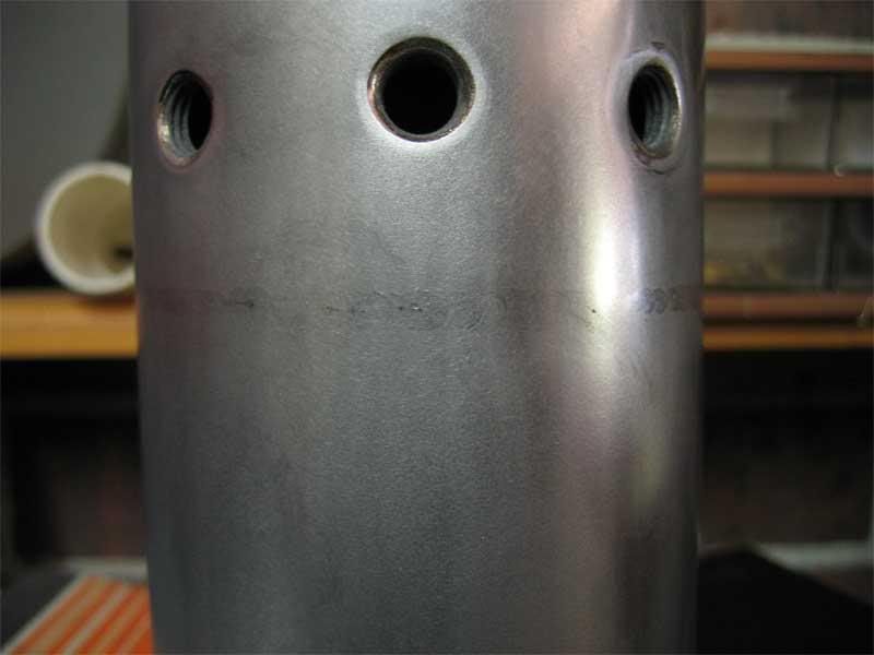

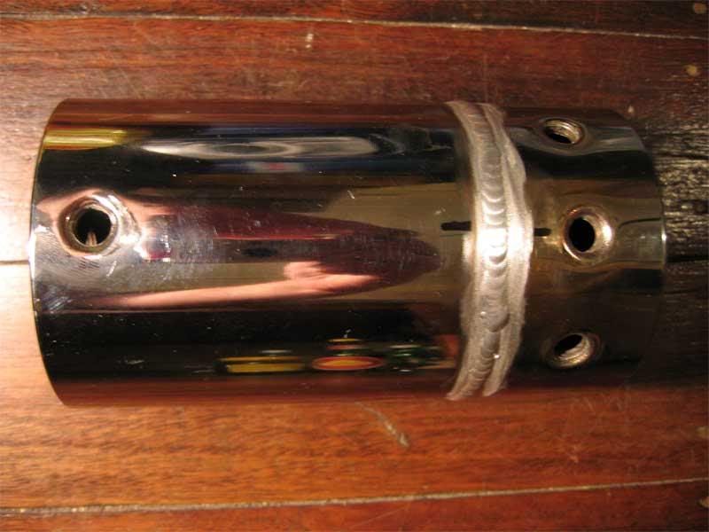

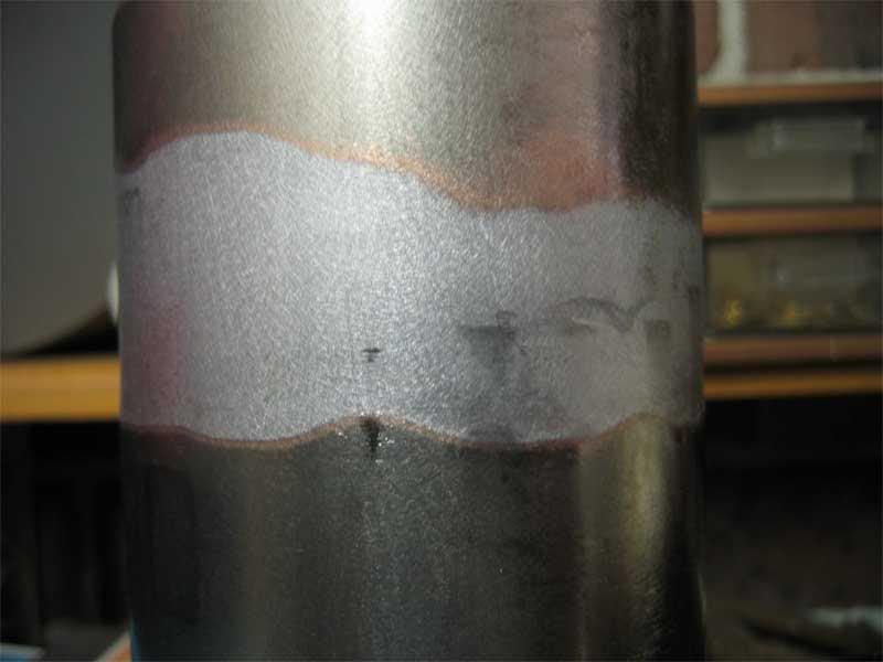

I was not going to attempt to Weld the can back together... so I sent it off to get TIG welded...
Because the can is Chromed Aluminium, the chroming process 1st involves plating the can in copper then chroming ontop of the copper.
You cannot TIG weld with copper or chrome layers around the weld so they had to grind back the layers to aluminium.
You would think that the guy who welded it together could have lined up the alignment marks better!!!

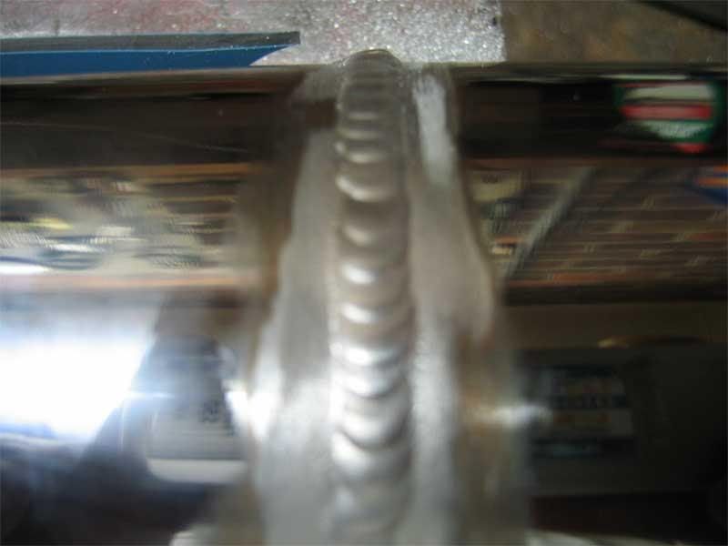

So now i wanted to reduce the weld so that it was flush with the can surface.
I especially cut the can here as this is where the mounting ring is positioned.
The Weld:

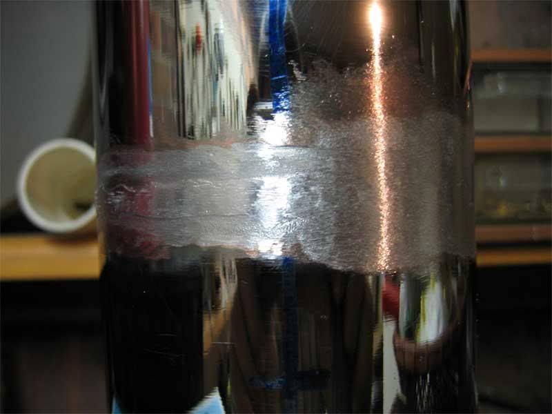

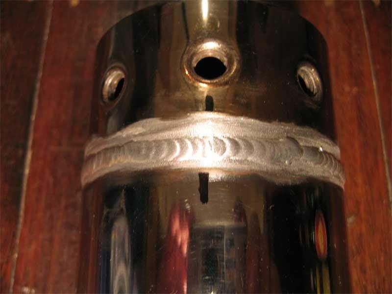

Filing down the weld... weld is easy... chrome is a biatch to get off!
Hit it with the orbital sander and plain 120 grit paper!
You can see the copper and chrome layers... I thought this was a cool effect and even though of leaving it.

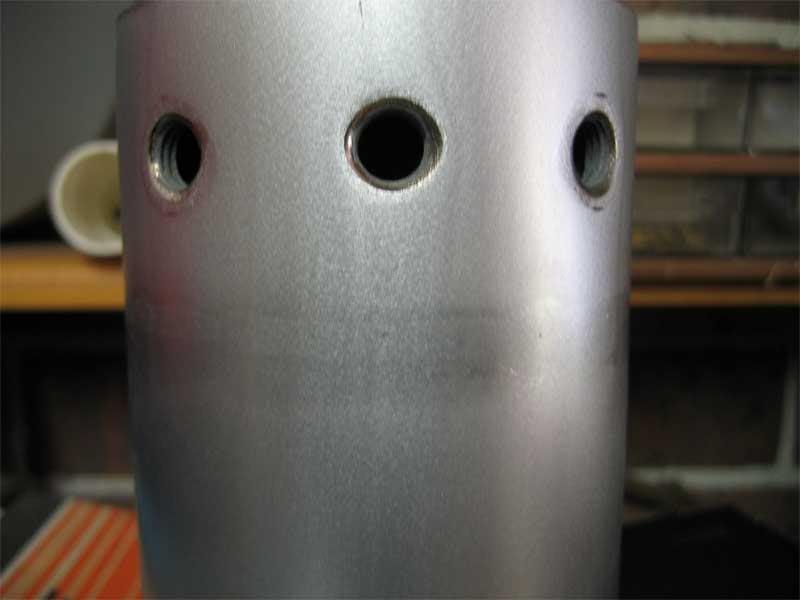

Taking too long with orbital sander... back to filing the whole can surface back to aluminium. Filing was much faster:
Final process... hit it again with orbital sander and 120Grit:
Hit it with orbital sander and Wet and Dry 400 grit then up to 1200 grit:
