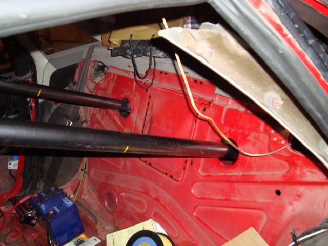

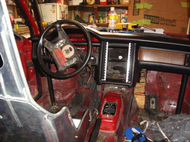

i wanted to not bake tire at all times....35r'd mk4...so when i had a little motor mishap, i got to thinking about swapping my 20v into an audi platform. only thing was even if i got a nice 99ish a4 with a toasted motor, it was still a bit heavy, and it still wouldnt 'legally' pass NYS inspection every year. so the idea was tossed around in my head and between a few other about putting a 4 banger 20v into an older audi chassis cause i hadnt really seen it done too much before, so after finding a donor car for $300 i figured id give it a go.
This car would not be where it is today without....
oldbetsy, whom is responsible for all of the welds you see below
speeding-g60, the electrical guru and master fabricator
[email protected], for all of the parts you see below through 034

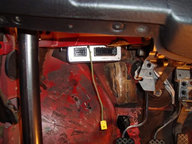

Kevin 'Lugnuts' Black, for the ecu/harness, and answering each and every question i had concerning it
Bob @ QED, whom will be responsible for putting the head together

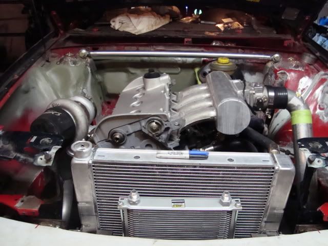

Motor Specs:

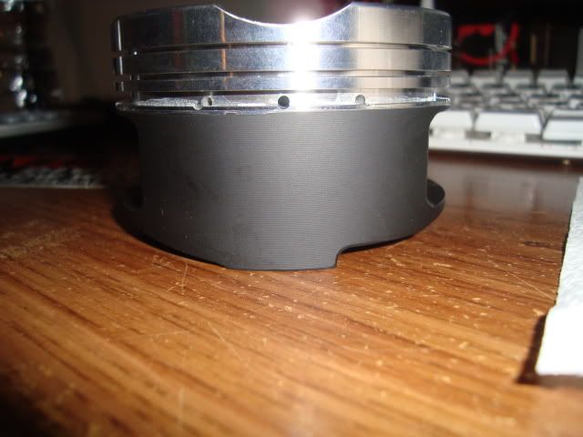

AWD block bored out to accept 83.5mm 8.5:1 JE pistons.
Scat connecting rods
AEG crank
ARP main studs
ARP head bolts
AEB head
Cat 3652 cams
Custom intake manifold
70mm mustang throttle body
Custom tubular exhaust manifold
Custom 2.5" hotside tubing, 3" coldside tubing

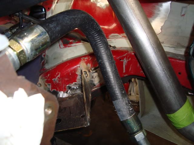

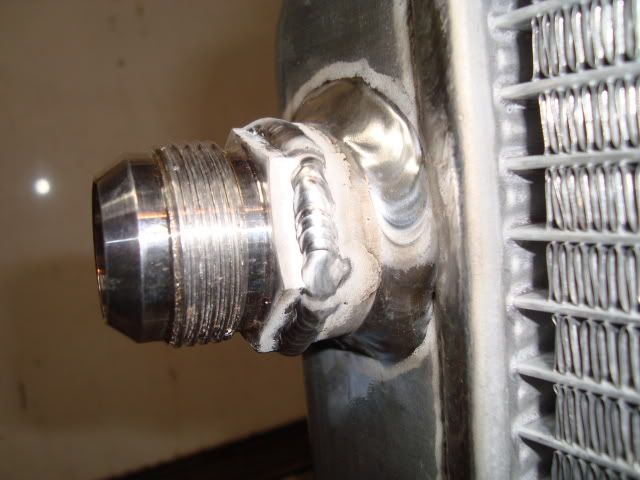

a big arse aluminum radiator with a 14 inch fan, all coolant lines are custom with -AN ends

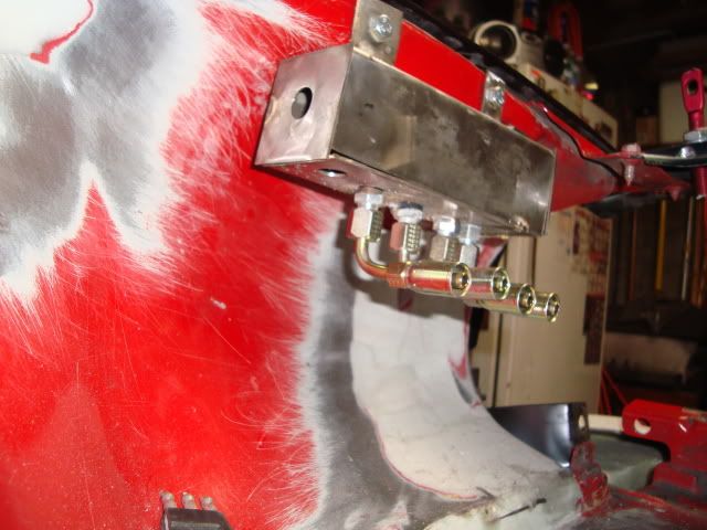

Custom fuel rail, -8 stainless braided line
Two Bosch 044 fuel pumps in the trunk fed from a fuel cell also in the trunk
Aeromotive fuel pressure regulator
16 row oil cooler
mocal thermo-plate

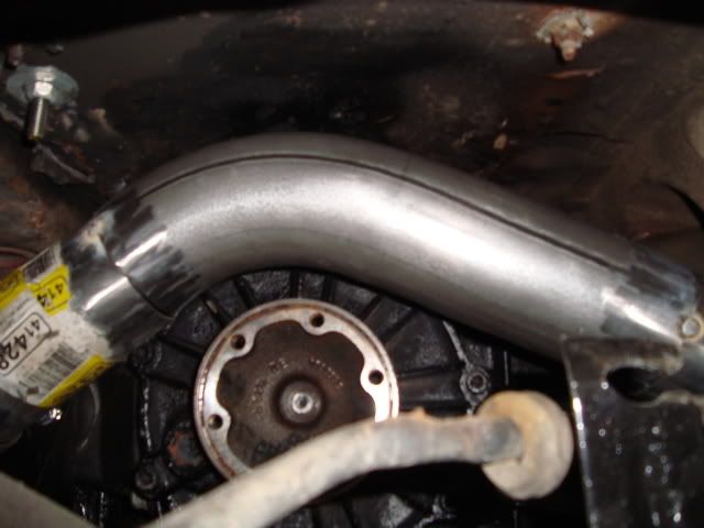

Custom 3 inch donwpipe, full three inch exhaust, Borla muffler
precision 750 core

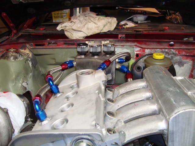

custom catch can
all to support a T3/T67 H.O. DBB
controlled by a LugTronic ECU.
im sure im forgetting other things, but thats the jist of it really.

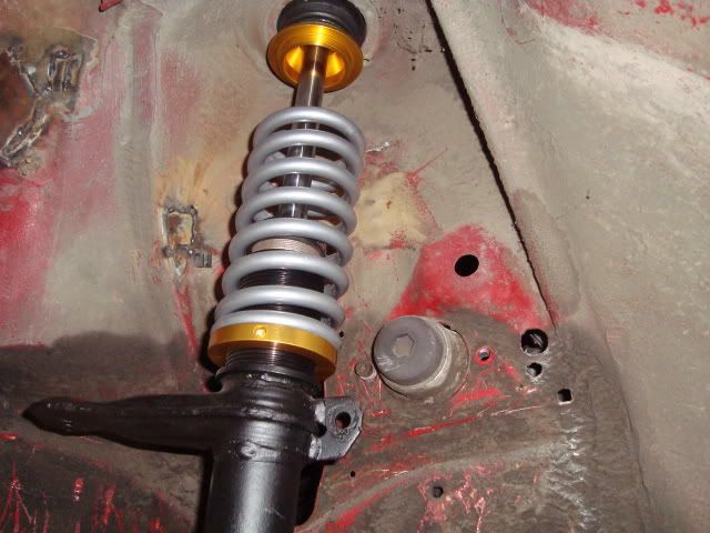

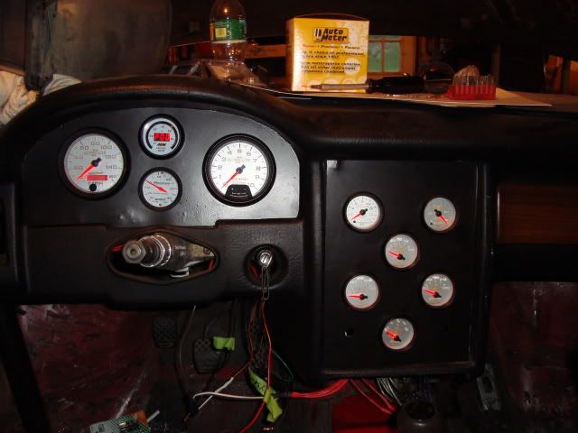

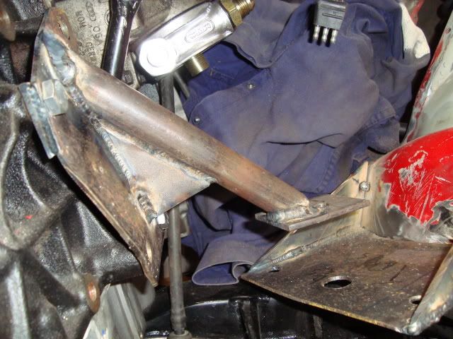

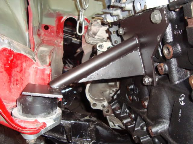

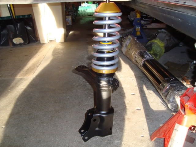

kirkeys aluminum seat, 10 point cage from S+W racecars. cool led gauges in custom dash. manual rear end locker. Custom built coilovers with KONI yellows in the strut tubes. Delrin motor mounts, solid motor mount brackets, aluminum subframe bushings, delrin control arm bushings, delrin rear diff mount. pretty much every mount in the car is either solid metal, or delrin.

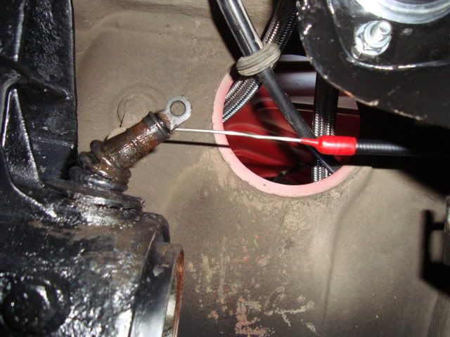

its an 01a tranny. they older b3/b4s also came with 01a's just like the newer b5's and such. the gearing is a bit different in them though since they came off of 5 cylinder motors. the ratios are pretty much in between an 01a from a 1.8t b5a4 and a 2.8 a4, so im hoping its an ideal setup for a larger turbo. also the rear diffs in the older cars are open just like the newer ones, but they had a vac assist locker in them....aka both rear wheels spin and have no choice. i just took out the vac assist part and set it up using an push/pull PTO cable.
