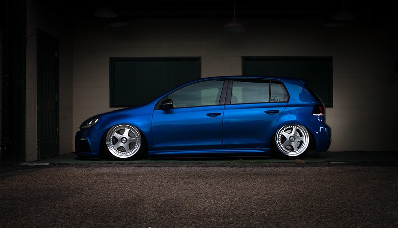

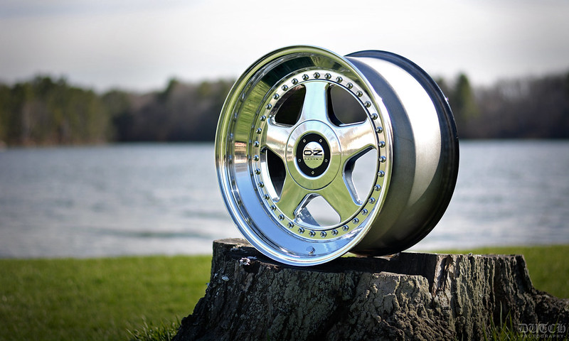

2018 SEASON BUILD
Specs:
Mirror Polished w/ Brushed Faces and Powder Coated Clear
19 x 9 et45
- 1.5" Lips
- 7.5" Barrels
(Reverse Mount)
225/35-19 Nitto NT555's
5X112
Rebuild Details:
- OG 18" OZ Futura 5x112 Reverse Mount Centers
- 18" to 19" Conversion Lips & Barrels
- Cleaned / Polished OEM OZ 10-Point Bolts & Nuts
- Gorilla Flush Mount Valve Stems (w/ Smooth Caps)
- Soudaseal 270HS Sealant
2016 SEASON REBUILD
Specs:
Faces Mirror Polished and Powder Coated Clear
18 x 10 et26
- 2.5" Lips
- 7.5" Barrels
(Reverse Mount)
215/40-18 Nitto Neogen's
5X112
Rebuild Details:
- New Fully Polished & Powder Coated Clear 5x112 Futura Centers (m298 & Old Style Cap Ready) - Purchased from Spinfab Design
- New 7.5" Barrels Powder Coated Gloss Black - Purchased from Spinfab Design
- Polished / Refurbished Lips - Done by Me
- Cleaned / Polished Shortened Original OZ Stainless Bolts - Done by Me
- New Gorilla Flush Mount Valve Stems (w/ Smooth Caps) - Done by Me
- Soudaseal 270HS Sealant - Purchased from Black Forest Industries
2015 SEASON REBUILD
Specs:
Faces Powder Coated Audi Quartz Grey Metallic
18 x 9.5 et27 (et22 w/ 5mm Spacers)
- 2.5" Lips
- 6.5" Barrels
(Sandwich Mount)
5X112
Rebuild Details:
- Step Up Lips/Barrels to 18" & Widen (9.5" all around) - Purchased from Spintech
- Polished Lips / Painted Black Barrels - Done by Me
- Fill/Redrill to 5x112 - Done by Spintech
- Powdercoat Centers Audi Quartz Grey Metallic (LY7G) - Done by Spintech
- Carbon Ring Reconditioning (They were painted black) - Done by Spintech
- New Centercap Hardware - Purchased from Spintech
- Shortened Original OZ Stainless Bolts - Machined by Shop R.H. Ripley & Son Inc. in Portsmouth, NH
- New Hex Nuts - Purchased from Black Forest Industries
ORIGINAL SPECS:
Faces Powder Coated Sequoia Green
17 x 8.5 et56
- 1.0" Gloss Black Lips
- 7.0" Barrels
17 x 9.0 et50
- 1.5" Gloss Black Lips
- 7.0" Barrels
(Sandwich Mount)
205/40-17 Nitto Neogen's
5x130
Built in 1993
