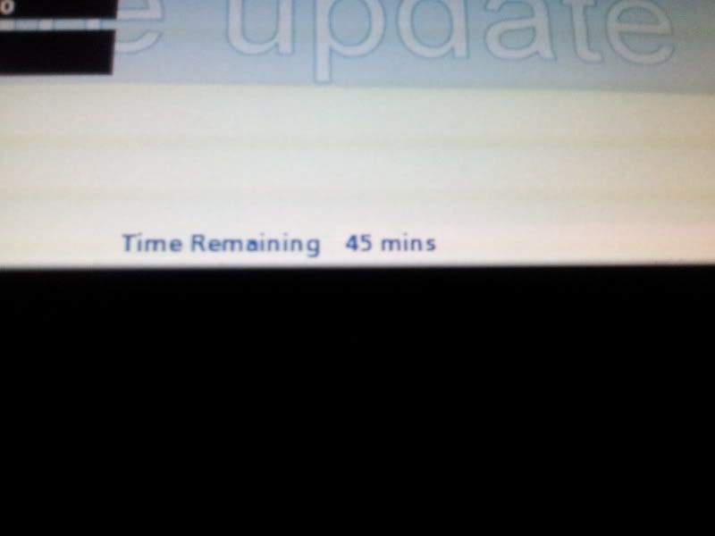

started with this, slowest part was APPL and Radio took the longest
you should see this at bottom of screen

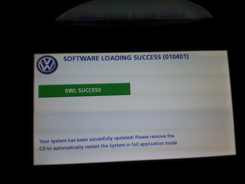

and go through a few of these screens
and this should be end result after about 45mis-1hr
