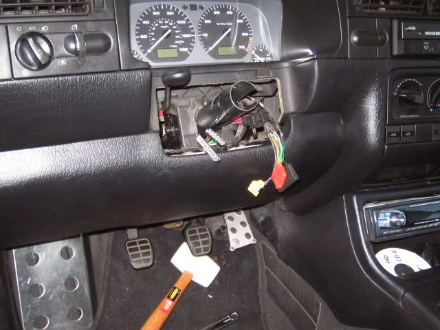

I snapped a few pics of the process for whoever so you'll know exactly what to look for..
here it is with the cover off..
the infamous u-joint..
it's a little tight getting in here.. hold the top bolt in place, undo the nut..
13mm, looks like this from the top..
unplug all these, including the airbag & the ignition..
this one comes out easily..
now you're ready to pull out the steering column..
now take the switch out with an eyeglass kit phillips head..
now put the new one in and put everything back together..
old switch/new switch comparison..

I just used a bearing seperator and pulled the switch housing off. then put in the new switch and put it all back together. Whole hell of a lot easier than taking the whole column out.

First timer here, using this method.
Took about 2.5 hours from start to finish.
Avoiding having to pull that 'steering wheel hub' off makes it a lot easier http://****************.com/smile/emthup.gif

figured i'd bump this up, cuz i just used it and its a quality DIY.
I'd like to add after you remove the bolt for the u-joint, you might need to hammer the shaft loose.

HA! I just finished it as well! Excellent write-up. http://****************.com/smile/emthup.gif
I did however have a hard time getting that damn little screw out that was between the steering column and the actual ignition switch
Had to steal a jewelers screw driver from my dad, and it was still a PITA. But it's all back together, and it works!
