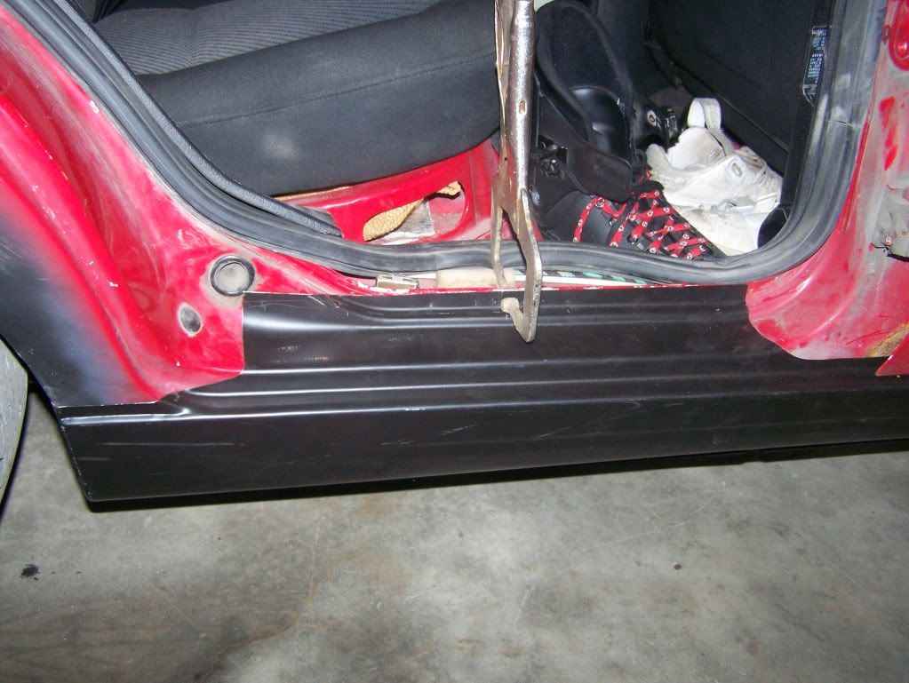

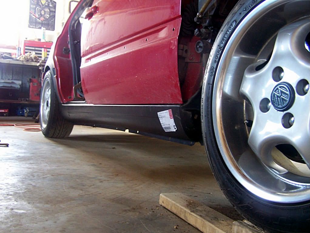

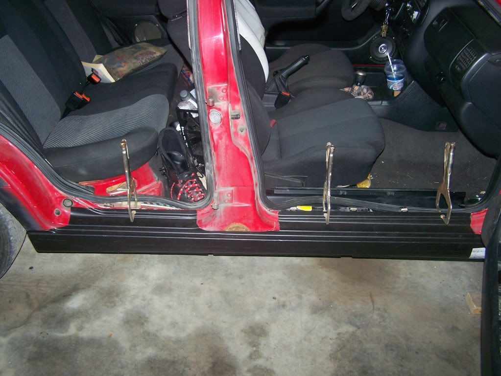

Just thought I'd post up sense I've seen a few threads asking about this.
Test fitted over the old rockers and they fit really well, so I'm just gonna cut out/grind any rust on the old rockers and give them a few coats of rust paint before I weld on the new ones. I did have to hammer the bottom of my rockers where the pinch welds are straight again after I dragged them over a few speed bumps.

Well I just kinda mounting them over the old ones, not really the right way to install them but this way save lots of time and add some strength.
First thing is to remove the fender and rear door if your a 4door that is. Then I had to trim a little material off the new rockers, then clamp em and weld them at the top first then pull them in at the bottom and weld again.
Note: Remove all rust from old rockers before mounting the new ones! I brushed on **** loads of rust paint as well!
Not much of a DIY I know. I just wanted to show it's not as hard as I thought it was gonna be.:)

Sherman Parts had them for like $26 a side, but I think they are double that now...probably cause a lot of people ordered them. I picked them up when they were cheap and may just end up selling them. I can't see your pics right now, but you should really cut off all of the old rockers instead of just mounting over top. If you mount on top of the old, I'd imagine they're going to stick out a bit and also there will be a nice space in between the backside of the new and old rocker for water to stay trapped in and rust out old and new unless you weld and seal the backsides of them too.
There was a guy who had a DIY that didn't even weld them...just used fusor body panel adhesive (108 or 108B). Just as good or stronger than welding, but it's not cheap stuff.

It would have been quite a bit more work to cut out the old ones. Your right there is a little space between them at the bottom, but no where that water would be trapped.
What I did first was spray undercoat on the old rockers and the inside of the new ones. There all welded in now and fit great.:)
