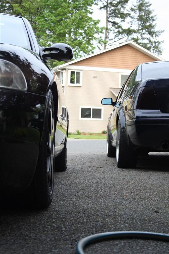

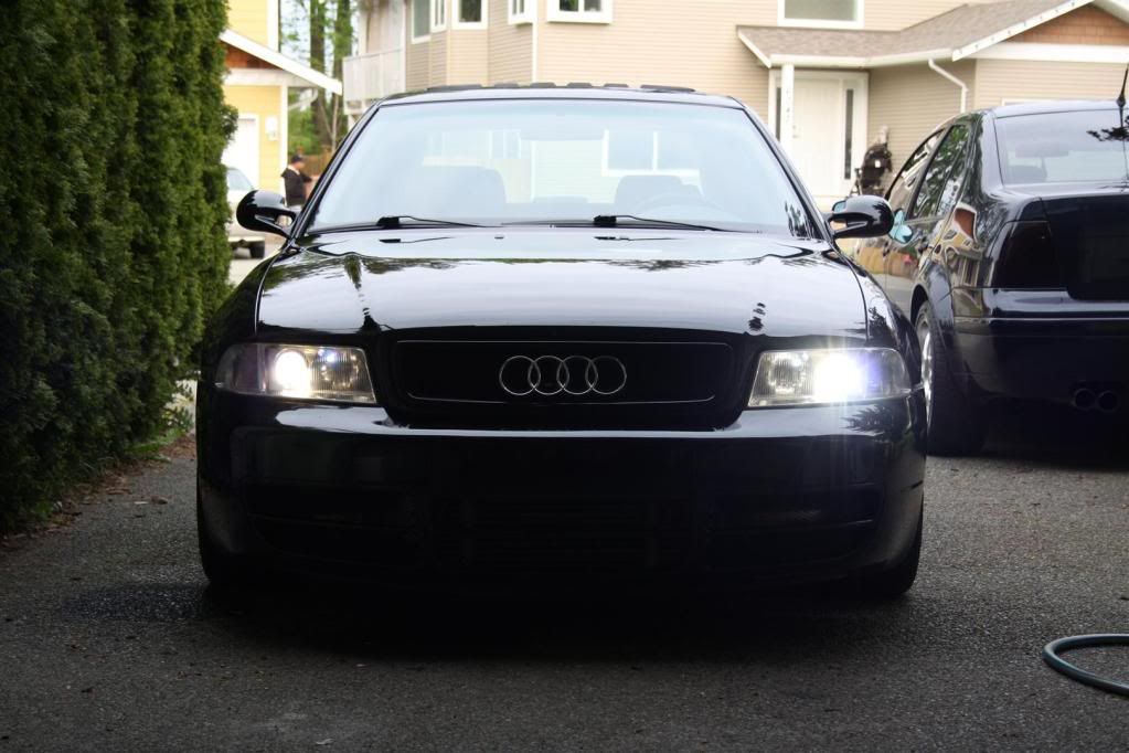

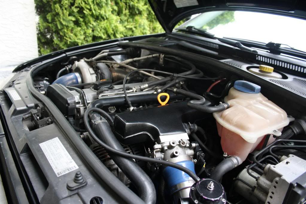

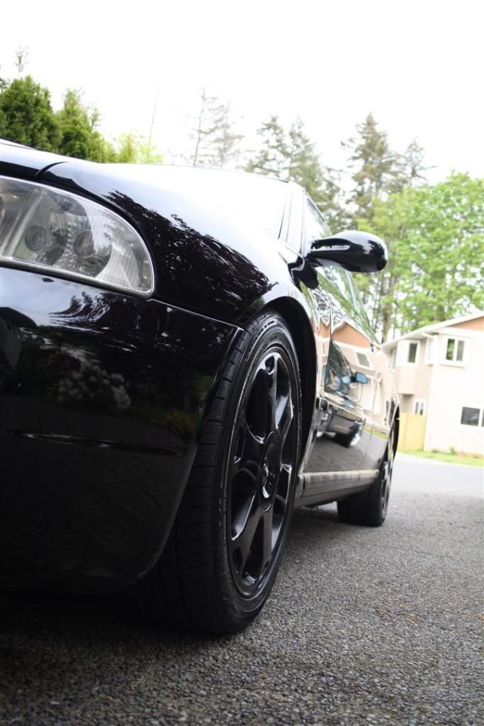

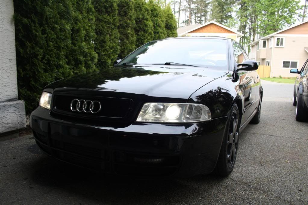

Got my car about a month ago, its a 97 a4 quattro, lowered on FK Coilovers, Brembo 2-peice rotors, 4 piston calipers, stainless brake lines, Spearco FMIC, built 1.8 from a passat, AEB head, Garett GT3076R Turbo, Tec3 Engine managment, custom exhaust, S4 Bumper, Grill, and wheels, Euro Headlights with HIDs.
Heres some pics, Enjoy :)

looks good but turbo looks rather large though(doesnt look like a 3076), whats the specs, power, and when does it spool?

nice car man. id ditch the side mirrors and tails though. get some oem pieces.

WHat Throttlebody is that? It looks monster... VR6? or what? And that turbo cannot be a GT30.. Looks more like a GT35 or 40... iverall the car looks great.

Boost kicks in at about 3200rpm, and holds 16psi till about 6600.
It was dyno'd at 345awhp on 16psi, and 419awhp on 24psi

Tial 38mm wastegate, and Greddy Type S BOV

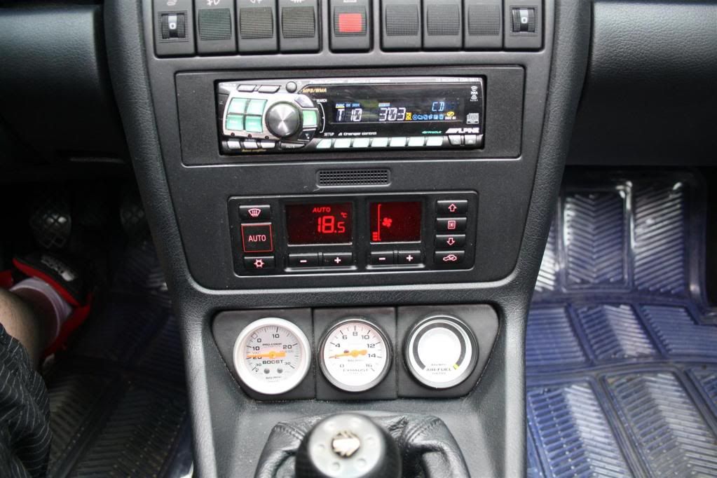

And Floormats are temporary lol.
