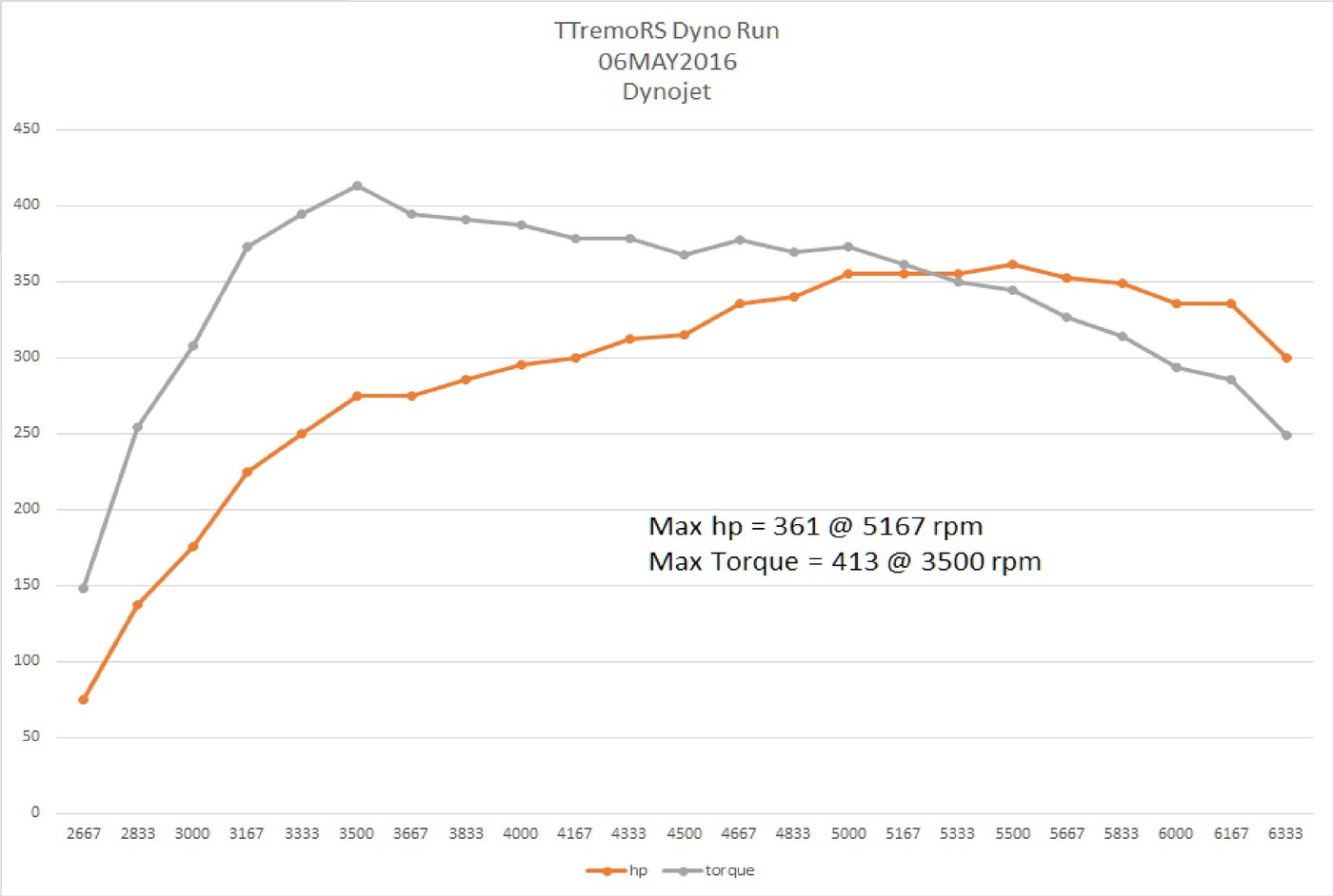

The car was finished 8 days ago... The event was a convenient option to get a "base run" for $25 off the appointment I made for Monday. I will be putting in Race Gas, and pushing the boost a bit more on Monday, but this motor has a LOT left in it. Iroz has this motor running 1000 HP. That is NOT my goal, I want a streetable road course car, but the potential is there.
The fact that that motor is in the car and running makes it a one-of-a-kind success in any event, I am VERY pleased with the results!

That number is a little un impressive, but I'm sure the power band is a lot more fun and driveable than the big turbo strokers that we see a bunch of.
Honestly though for that kind of investment of time and money I would want more.
Seeing as how the motor is built I vote corn juice.

it's funny how all everyone cares about is max power. my TT on E85 probably makes 300whp 350wtq on aggressive tight turns it's pretty easy to spin all fours coming out of corners and through corners if your into the throttle too much , with full suspension and 245tires
I think this project is amazing , the outcome is making big turbo 1.8T power without any of the lag! plenty of potential left in this setup.

stock turbo? this is it.
all he has to do is add a bigger turbo and retune... and he can gt 650-800-900 etc... the motors it there for it.
adding more boost to this setup on stock turbo MAY add ore torque but the stock turbo is flat after 5000rpm. so heat is a factory when adding more boost....so in the end? it really wouldn't make more power till the turbo change happens. limit on stock turbo is about 480bhp and 490-500btq. which is about what was proven on the dyno charts.
