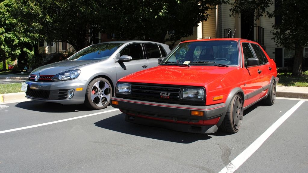

Hey guys, I've been wanting a MkII for over a decade and finally pulled the trigger last weekend. For the next year or so the car will be my daily, so the primary focus now is getting all the mechanicals upgraded and the car running 100%. Eventually I'd like to pretty much restore the whole car back to original condition aside from coilovers and Fifteen52 16" Teardrops (if they ever build them). That said the car refused to start friday morning and I ended up having to walk to work. I knew a 24 year old VW was going to need some TLC but I was hoping it'd make it at least a week without leaving me stranded :laugh:
Luckily my brother is a VW tech and enthusiast so he came over today and helped me look things over. Turns out there's oil in the distributor and we're getting no spark. Got online and ordered a new Bosch distributor, plugs, plug wires, and coil so I can overhaul the ignition system next weekend. Hopefully that'll do the trick. Anyway, here's a couple pics from monday when I brought it home. The MkVI is my previous daily - 2012 GTI. Its getting turned in on a 2013 TDI for my wife.
