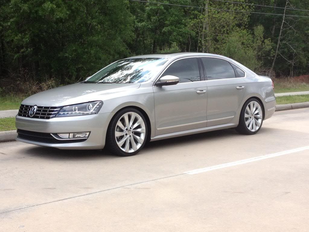

2012psst: H&R Coilovers

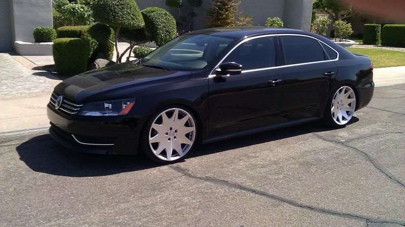

i just had to post a picture of my car lol
Haha...much appreciated. What's your setup? Also, still want those wheels...had a chance to get a set but since you and VAGwhore have them, I didn't want to be number three.
