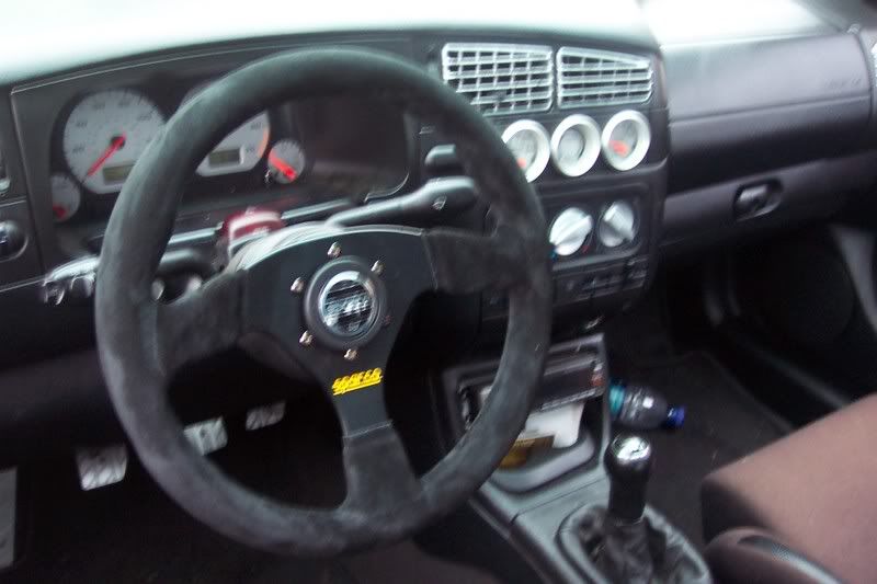

i purchased a mechanical autometer oil pressure gauge off the 'tex, and i really don't feel comfortable with 80+psi in my dash so i'm going to buy an electronic one, my question is, how different is the hook up for an electronic gauge to a VR as opposed to a 2.0, i know the wiring doesn't come with the gauge, but the sender does, is there anything else i should know or need before i embark on this adventure? http://****************.com/smile/emthup.gif
pic for clicks (not mine)

thats my interior
yeah go with the electric gauge and get the adapater from 42DD, I always wondered if they can be wired to one of the stock oil pressure senders on the 2.0, theres one on the block and one on the oil cooler
