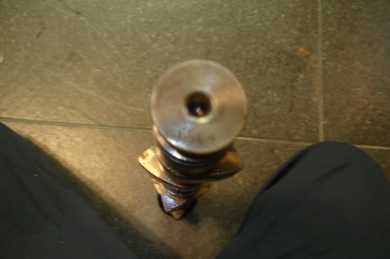

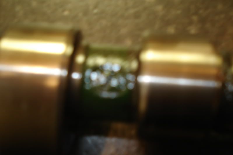

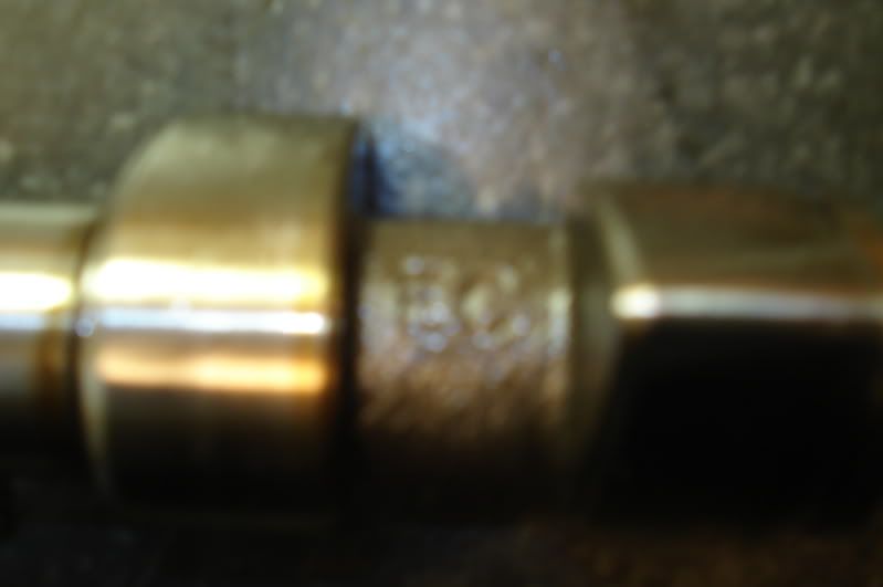

I have being searching for hours and haven't being able to find something to help me identify it. i would messure it but don't have nothing to do it with
the only thing it has stamped at one end is ECE4 and then it has a 7 and the letters EC casted into it please help me out trying to find out if i could put this in my project.
here goes some pictures sorry for the bad quality

it is a VW watercooled inline 4 cam.

The Easter egg logo is actually a Cam lobe, the official logo of Estas Cams.
This company is based in Turkey, has locations in the UK, South Africa and now in Lake Forest CA.
Estas cams are sold by Autotech, TT, Eurospec, Shimmel and others.
Some tuners use blanks that are ground to their specs.
Sorry I can't give you specific info about the part #.

Quote, originally posted by mk4chris »
i cant find an easter egg logo on it. just has a number 7 there
Your own pictures.
Both look like it, but they are not clear pics.

your right found the Easter egg i checked all the company's web sites and cant find a part number even close. the closes one was eurospec.
