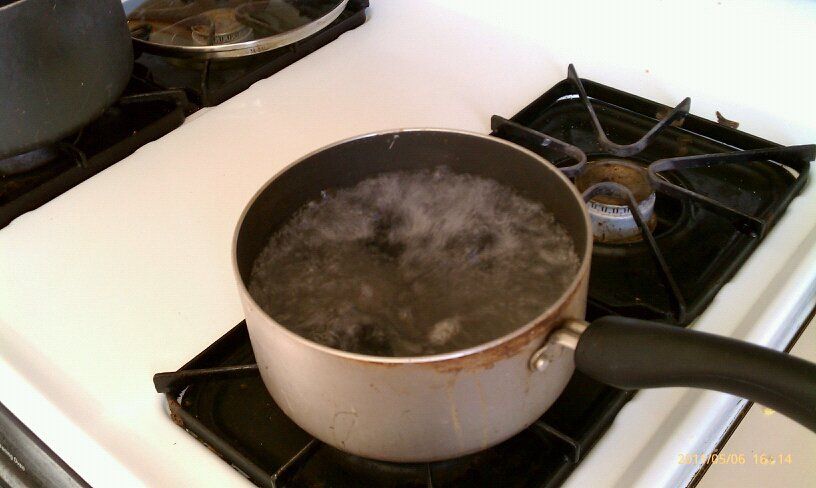

What are those things boiling in the pot on the stove? :beer:
9,397 Posts
Discussion Starter · #10 ·
Really nice work!!!
the front crossmember bushings. it took me about 2-4 hours to figure out how to get them in there, but once i did, they went in smoothly. you can see in the pics that i started at 4pm and finished at 9pm with 4 bushings.:banghead:
:thumbup: for doing things right. Looks like alot of fun.

Those bushings are a pain in the ass, even with a press. I ended up destroying two last time I did that.
Seems like boiling would make them more pliable... but also expand.
9,397 Posts
Discussion Starter · #12 ·
boiling made them much softer so i could press them in with a few screwdrivers and the weight of me on a wood board. i kinda wish i have gotten a poly bushings instead, but i dont feel like doing them again.

I wonder if boiling poly bushings would soften them up enough to get them in. Till this day i can't my ProFlex bushings in. :facepalm:
Love this build BTW. My kinda build for sure! :thumbup:
9,397 Posts
Discussion Starter · #20 ·
^ give it a try. I boiled them for good 15 min before getting them in. I also used a bunch of mobile 1 synthetic grease on them and then I jumped on them as hard as I could. Finally, they gave in and it was done. Never again will I replace those sh1ts. Pain in the ass.:cool:
