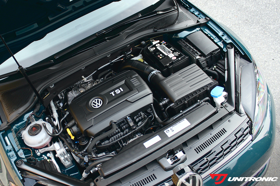

In stock trim, the 1.8TSI MQB engine comes equipped with an IS12 turbocharger and develops 170 hp and 199 lb-ft of torque but VW left plenty of room for improvement. With our Stage 2+ Software and Genuine IHI IS38 Turbo Upgrade Kit, we will more than double the horsepower to 352 HP and increase the torque to 324 LB-FT on this Alltrack. These power levels are within the safe limits of the engine and DQ250 DSG transmission equipped on our vehicle and the required hardware upgrades will help ensure trouble free operation and maximized performance long term.

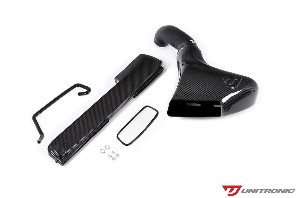

Starting at the front end of the vehicle, our Carbon Fiber Air Duct takes advantage of both air inlets available in the OEM grill and its smooth transitions provide an alleviation in the restrictions present with the OEM front air duct. This ultimately lowers turbocharger shaft speed to achieve target torque and thus, boost pressure, resulting in lower stress due to slower rotational speed. A turbocharger that incurs less stress typically experiences greater reliability and benefits from an extended lifespan as well.

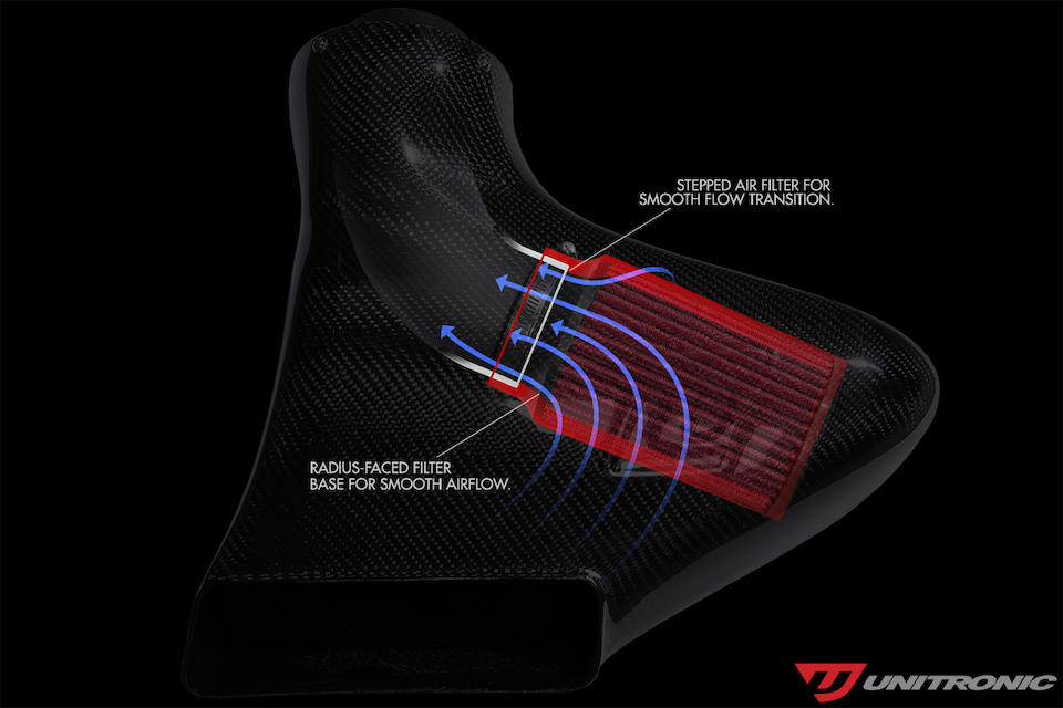

Next, our Carbon Fiber Intake System, provides increased power, air velocity, and throttle response, while also decreasing air intake temperatures and turbo lag. It’s specifically designed to take air in from its oversized air inlet and continue through its proprietary air filter featuring a radius-faced filter base, acting as a velocity stack to assure smooth and laminar flow between air filter and inner aluminum intake tube. Airflow continues through its five-ply silicone turbo inlet hose, to the Turbo Inlet Elbow.

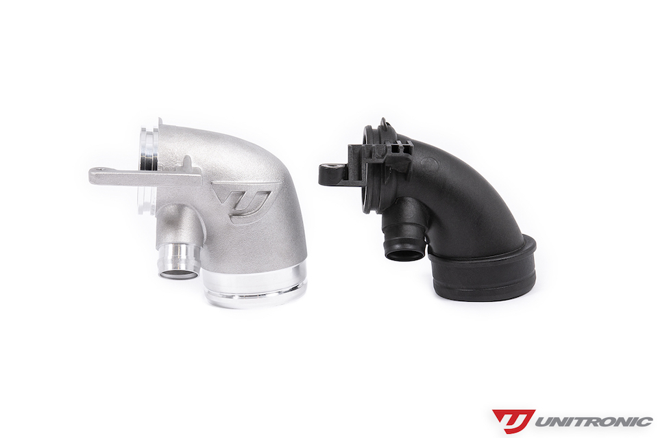

Our Turbo Inlet Elbow is designed and engineered to further eliminate airflow restrictions found in the OEM unit, allowing for it to both outflow and outperform anything on the market. It is optimized to perform to the maximum up to 50 lb/min, which far exceeds the airflow demands of any IS-model turbo and hybrid variant.

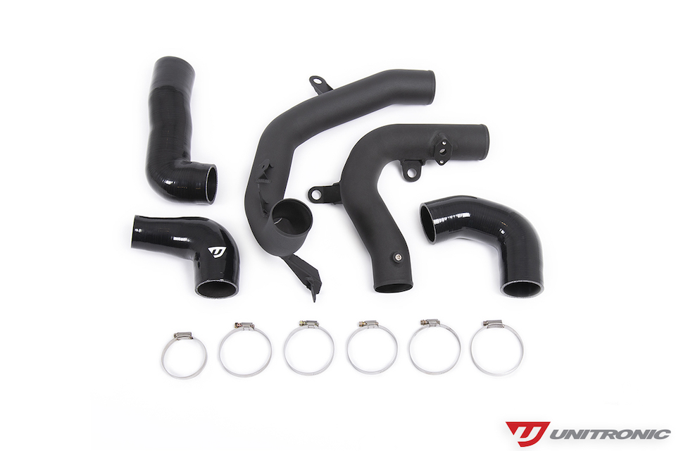

Given the scope of the project, we'll also be alleviating intercooler plumbing restrictions with our Charge Pipe Upgrade Kit which is comprised of an upgraded Turbo Discharge Pipe, Throttle Body Pipe, and reinforced silicone intercooler inlet/outlet hoses. This kit features high-flow designs that eliminate restrictions in the boost (charge) piping leading from the turbocharger outlet to the engine, allowing for unrestricted airflow and more power.

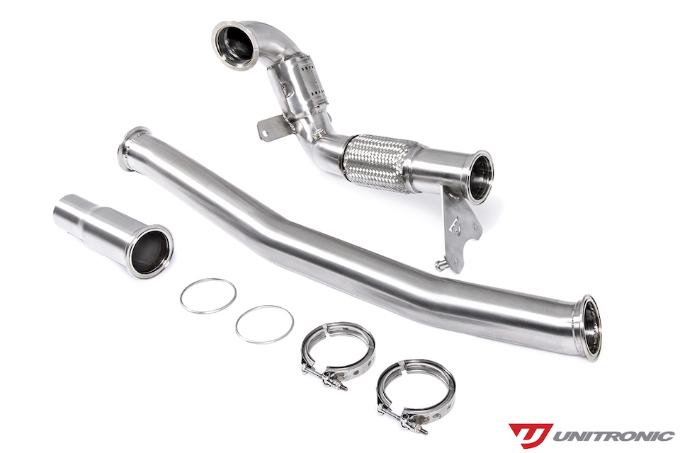

On the exhaust side, we’ll be utilizing our 3" Downpipe for 1.8TSI MQB AWD vehicles. It is constructed of T304 stainless steel mandrel bent tubing and T316 stainless steel flanges. This Unitronic downpipe comes equipped with a 200-cell high flow metallic catalytic converter and an OEM-inspired heat-shield which protects against unwanted heat radiating in the exhaust tunnel. All transitions are flow-matched to allow for maximum performance and installation is made simple with the help of an easy-to-use v-band exhaust fastening system which also ensures precise fitment.

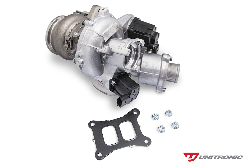

Last but not least, the factory IS12 turbocharger will be upgraded to a genuine IHI IS38 Turbocharger also found on the Golf R and S3 2.0TSI MQB engines. With the help of our Stage 2+ Software, our little 4 cylinder 1.8TSI engine will be producing 352 HP and 324 LB-FT of torque which will undoubtedly help improve passing power and acceleration times.

Unitronic®'s Charge Pipe Upgrade Kit for the 1.8/2.0 TSI MQB engines is comprised of an upgraded Turbo Discharge Pipe, Throttle Body Pipe, and silicone intercooler inlet/outlet hoses. This complete upgrade kit features a high-flow design that eliminates restrictions in the boost (charge) piping leading from the turbocharger outlet to the engine, allowing for unrestricted airflow.

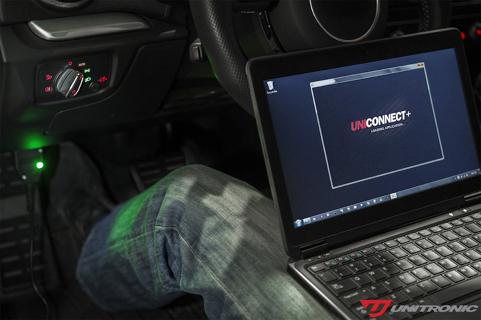

Now that our Hardware upgrades are complete, it’s time to hook up our UniCONNECT+ Cable to the Alltrack via the OBD-2 port and flash it with our Stage 2+ ECU Software for maximum power and Stage 2 TCU Software for increased clutch clamping pressure, quicker gear changes with optimized shift points, increased launch control RPM and an overall more responsive driving experience.
Unitronic UniConnect+ Cable
Along with upgrading your Performance Software from the comfort of your own home, this cable also allows you to flash your vehicle back to stock as needed, perform diagnostics and new for 2021, we’re introducing a high speed data logging feature for today’s most popular VAG vehicles.

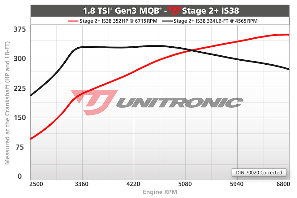

Unitronic’s facilities feature very sophisticated tools and equipment which allow us to engineer the finest automotive performance products on the market. One of these tools is our MAHA Chassis Dynamometer, which gives us the ability to conduct extensive research, development, testing, and validation of our Performance Software and Hardware products completely in-house. This dyno sits inside a state of the art, environmentally controlled cell which allows us to dial in specific conditions to assure reliability of our performance products anywhere in the world.
Unitronic Mk7.5 Alltrack is38 dyno
As expected, the Alltrack performed very well on the dyno achieving our published Stage 2+ IS38 power figures along the way. Ambient temperature was set to 72°F (22°C) and we performed 3 pulls which averaged between 353-348HP. Given the current winter grade 93 octane fuel in the car, we did see a bit of timing correction but the ECU showed its ability to correct such. Additionally, our Stage 2+ Software allows us to safely run up to E20 to further correct this if needed.
All this additional power is achieved through an increase in boost pressure, optimized ignition timing, camshaft timing and much more now that our turbo and hardware upgrades are complete. As you can see there’s plenty of usable power starting at 2500RPM but the turbo really comes to life above 3000RPM maintaining peak torque all the way to 5000RPM while horsepower climbs all the way to redline.
Unitronic 1.8tsi stage2+ dyno
Power delivery is smooth and linear and on the street there’s a drastic increase in acceleration, passing power and top end power especially compared to the stock 170HP / 199LB-FT figures. With these upgrades, low 4 second 0-60 times and mid 12 second quarter mile passes are achievable with DSG equipped vehicles depending on setup.

Any chance you will release the dyno charts? Or let us know the WHP? I am very excited to go this route later this year with my gsw. I am also curious if you could give me more of the sounds with the stock exhaust and uni downpipe/is38, specifically if there are any pops or bangs, I thought I saw that as an option on your website in the past. And one last question on the e20 is that possible without any further fueling modifications? Thanks for the series!
#36 ·
The vehicle achieved published power numbers indicated with crank figures in our latest post but 15% drivetrain loss is typically a good average to use for WHP. We don't have sound clips to share at the moment besides the one in the video above but this particular vehicle does have a muffler delete as well as the upgraded Unitronic DP. Adam Karst has shared a few exhaust clips on his YT channel in the past if you'd like to check them out. Crackles are not available for the 1.8TSI engines at the moment and yes, this calibration is optimized for 93 octane but you can safely supplement with up to E20 to correct timing pull without any additional modifications.
Will you be doing any ignition or fueling upgrades to support this or are they not needed with this setup. Will engine mounts be wearing out faster?
Additional fueling or ignition upgrades are not required at this power level. Engine mounts would be a welcome upgrade long term though.
