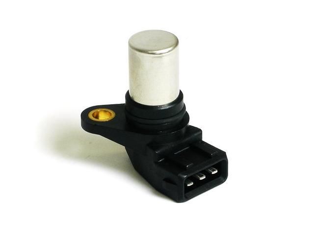

So I posted this in the mk4 forum and they told me to bring it here. I got a motor from a local place that parts out vws. They said it was out of an 01 jetta. My car is a 99.5 and the motor mount broke off of the block. I put this new engine in and now its cranking and not starting. I had to transfer over the crank position sensor, and the front and rear knock sensors because they were different than the ones on my harness but they matched up to my block. also I had to splice in the cam position sensor. because that was competely different. It is showing the following codes

The top sensor was on the new engine (claimed to be from an 01) bottom sensor on the old engine (99.5)

So I took the crank position sensor off, and checked it with a volt meter, it tested ok, put it back together, and it started first crank! so pumped....the plug must not have been seated properly or something. anyway, I do really want to know why this thing has a cam position sensor from a mk3 on it. are the upper timing chain covers interchangeable on the 2? could someone have changed the upper timing cover over and needed to change the sensor aswell. Is it possible that this engine is out of a mk4 passat? I know its not a mk3 head because the intake manifold bolts up. Im pretty sure it was showing the injector codes from trying to crank it without the fuel pump fuse in...
pretty stoked to hear the sweet purr of my vr once again:cool: now I Just need to get my insurance reinstated and get an inspection...lmk what you all think about the cmp sensor

so now the only code being shown is p0343, cam position sensor input too high. Does this have to do with my ecu being programed for the original cmp? what can I do about this. I havnt gotten to take the car out and drive it yet because im parked into my garage and I have no insurance right now. so I dont know weather it is driving ok and if it can run for extended periods of time.

Chances are the cam sensor needs to be replaced if it's giving a constant CEL rather than clearing out when you cleared all the other codes you had.
