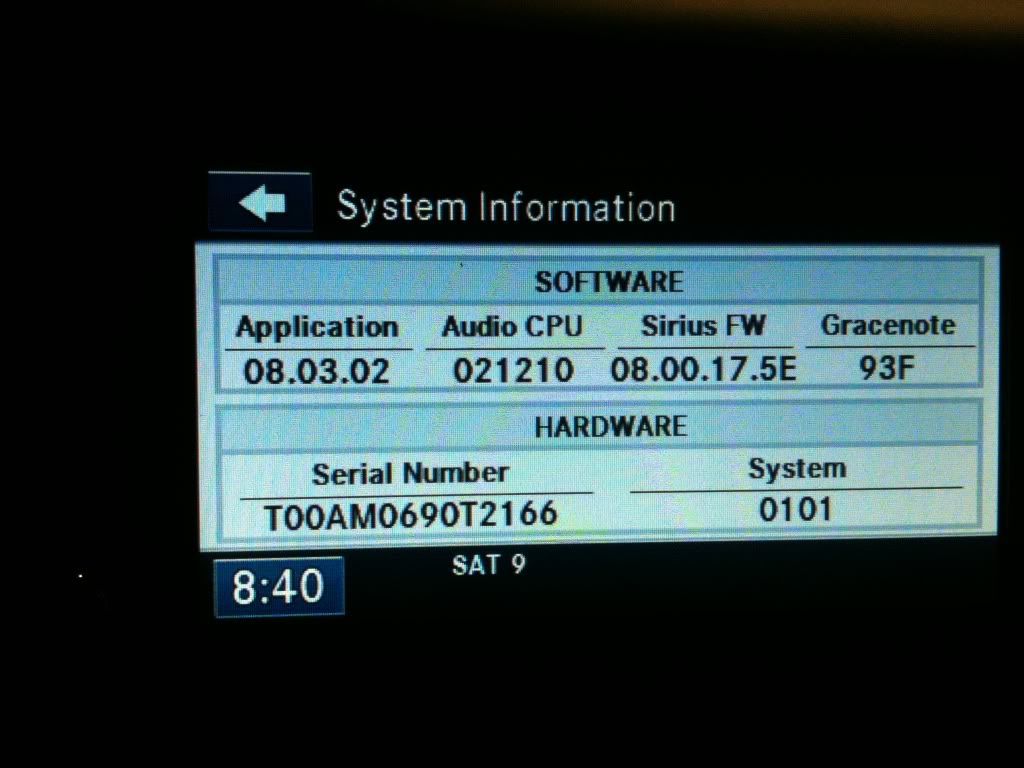

1. Check the radio software version.
a. Press “Menu” button on the radio.
b. Press “System Setup” touch screen soft key.
c. Press “System Information” touch screen soft key.
d. The software level is the number reported after the word “Application”.

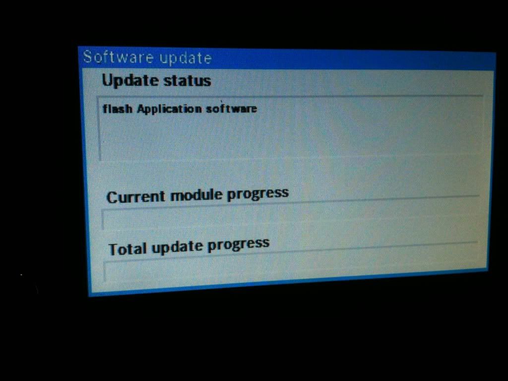

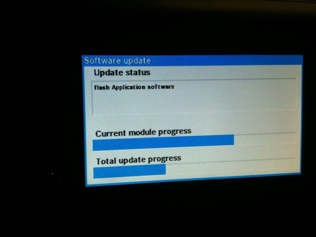

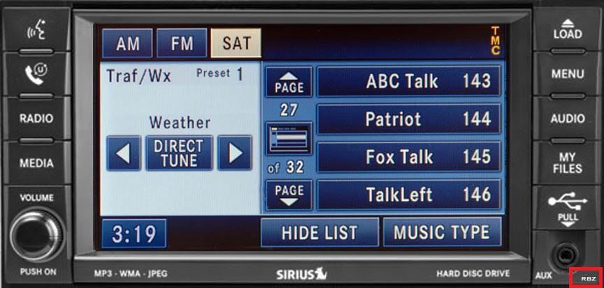

- Confirm you have RBZ RADIO (Model# located next to Aux Input)
- Check your firmware (See TSB below)
- Download firmware 8.05.01 (15.9MB) from

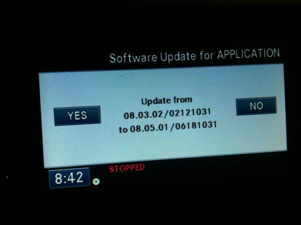

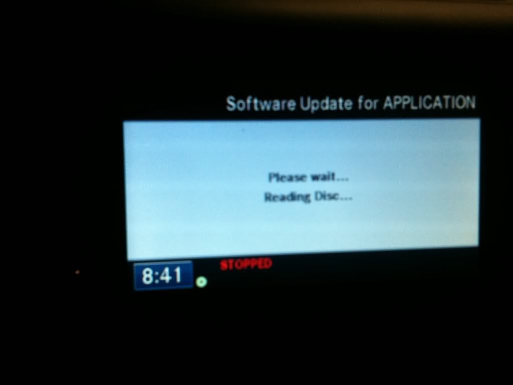

- Open the .ISO file with your CD burning software and burn a CD. You can download a free version of Nero here:
- Turn Ignition to On position (not accessory) and insert the CD. Further instructions are listed in the TSB below.
- After the update is complete it will reboot and come back to the upgrade screen. Select No and eject the disk.
The only setting that went back to default was the radio EQ. My Sirius radio presets and blutooth pairing did not reset
