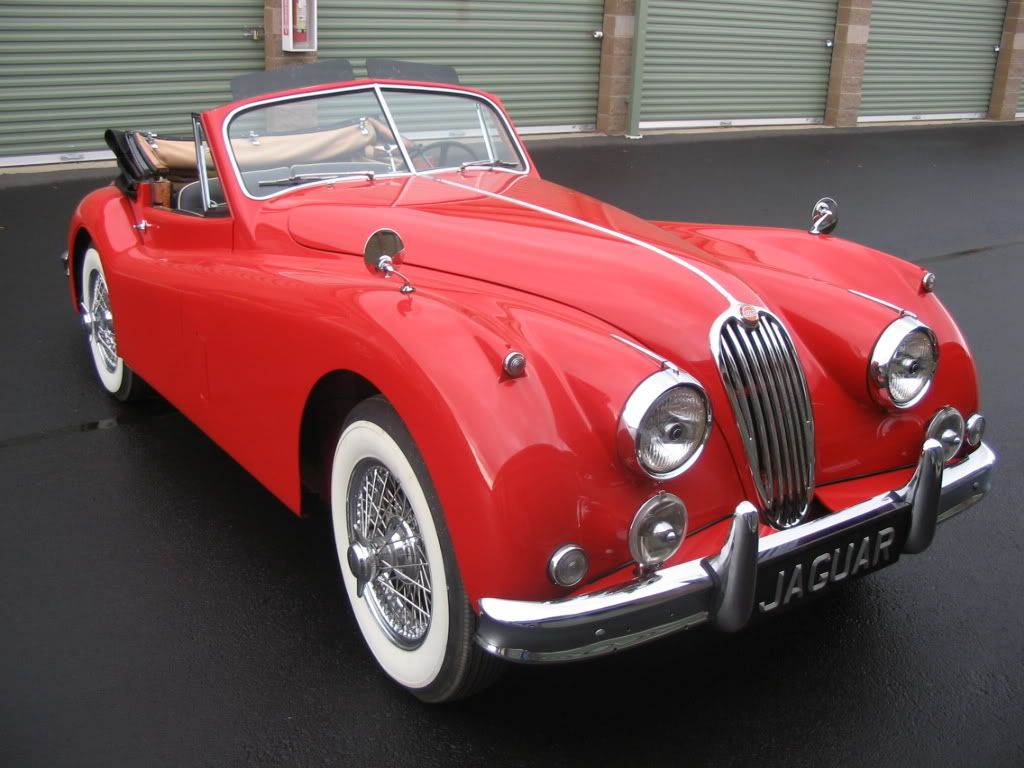

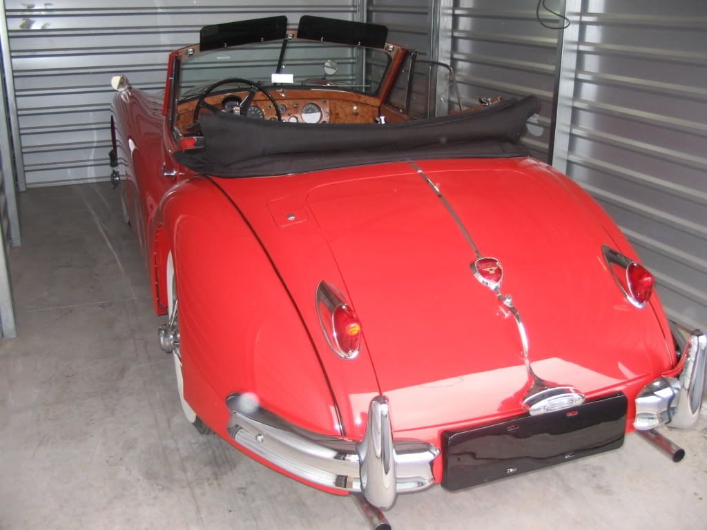

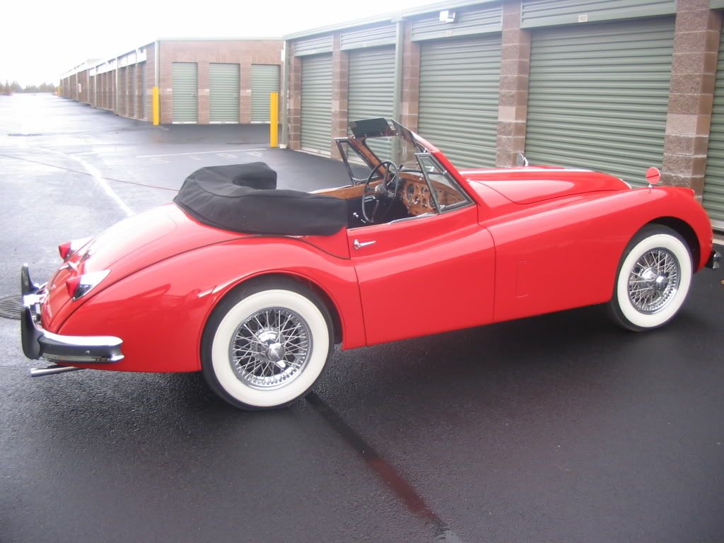

That was kinda what i said... I guess no one else thinks so... This thing MUST have sat in a garage for 50 some years... Its a CALI CAR!
1,017 Posts
Discussion Starter · #10 ·
Re: Restored 1957 Jag (Spectaculiciousness)
Quote, originally posted by Spectaculiciousness »
"This is a beautifully restored Jaguar"
Says right in the add it's a resto. Sweet car, but I doubt it's been sitting for 50years
I got that... But none the less It would appear that it was straight from that time period.

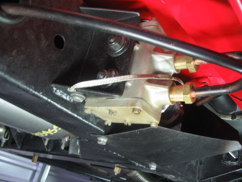

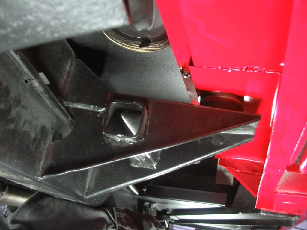

128 Posts
Re: Restored 1957 Jag (Ronus4265)

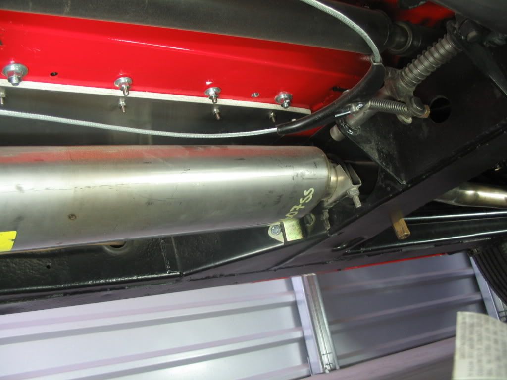

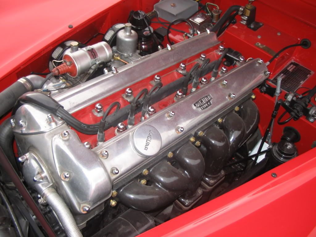

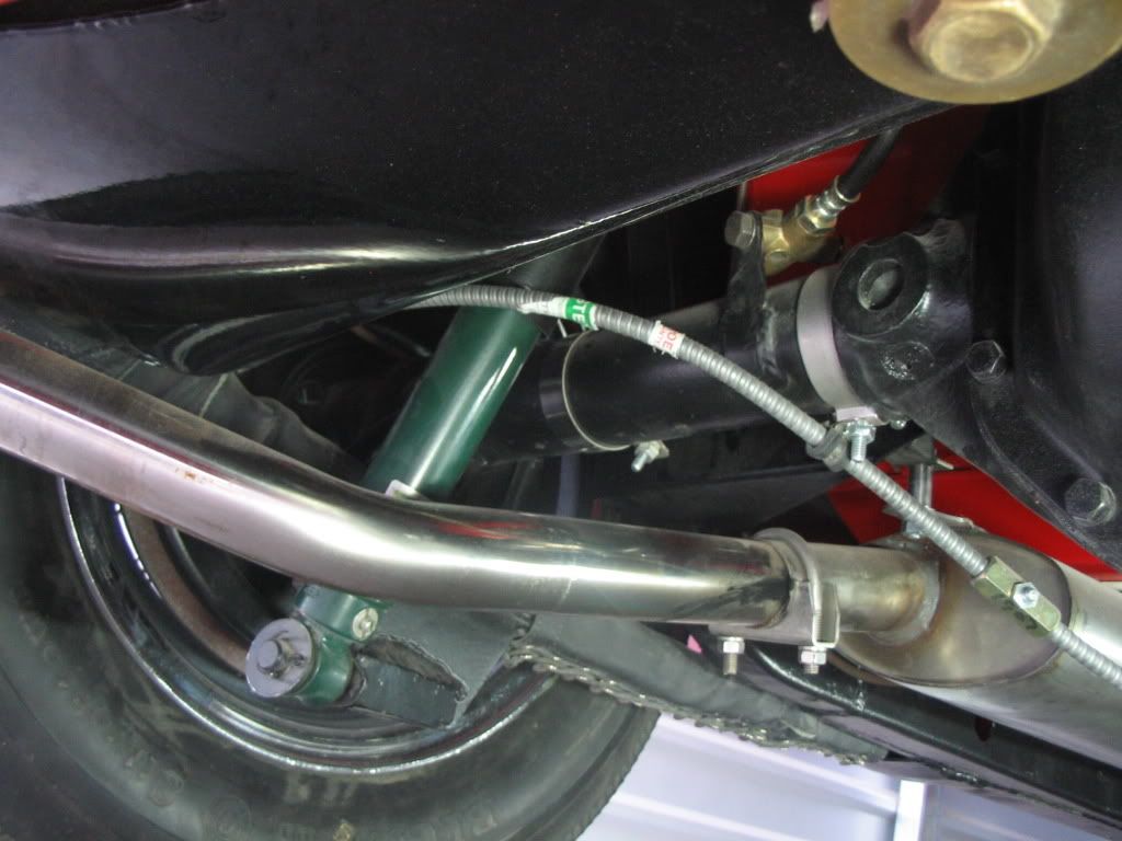

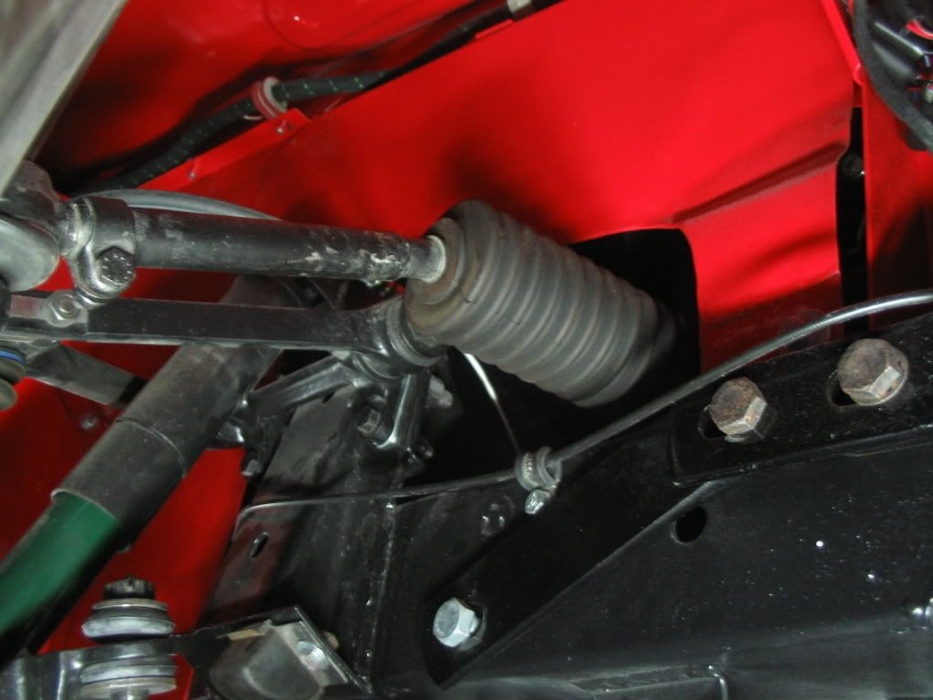

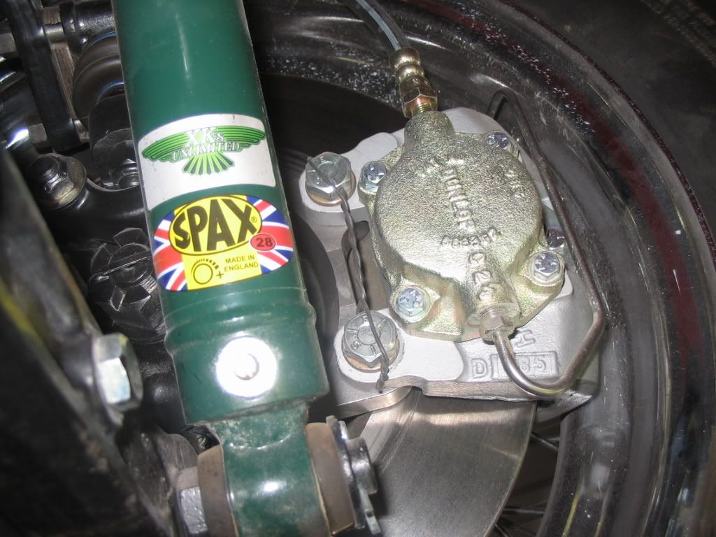

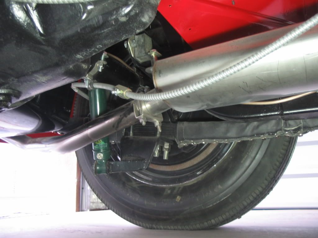

Nice Car,
But for 140k for a droptop you would think they could wire the caliper bolts correctly and at least take the stickers and yellow writing off the exhaust.
The writing on the E-brake grease fitting could have been removed easily.
Also, nylocs didn't come on these cars, they weren't invented yet.
Bolts are too long in some places.
The wood in the interior is too light in color. It's been redone but should be darker.

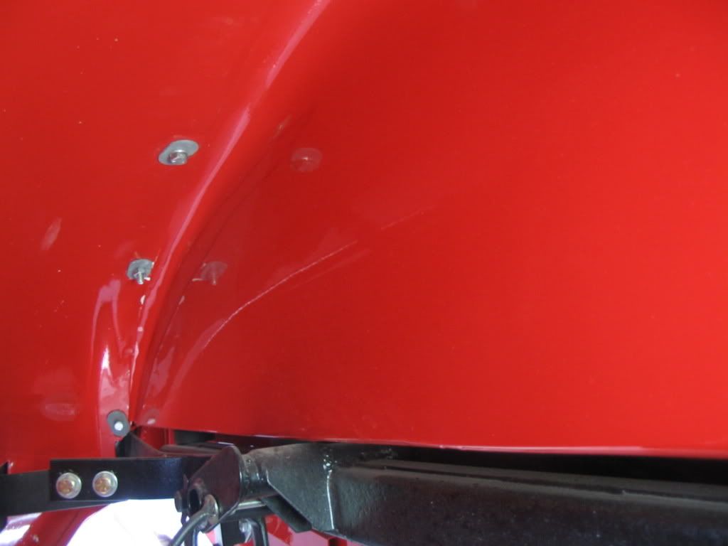

Body looks good though, crappy weld on the seam under the car.
BA
Modified by Ezhoracing at 7:36 PM 3-20-2008
· Old man yelling at cloud
8,946 Posts
Re: Restored 1957 Jag (Ezhoracing)
Quote, originally posted by Ezhoracing »
Just curious; how should the caliper bracket bolts be safety-wired?
Nice Car,
BA
I hope you're kidding. Or just Ignorant. A modern day restoration is an attempt to make the car look like it came off the assembly line, stickers, grease pen signatures, quality checks, etc...

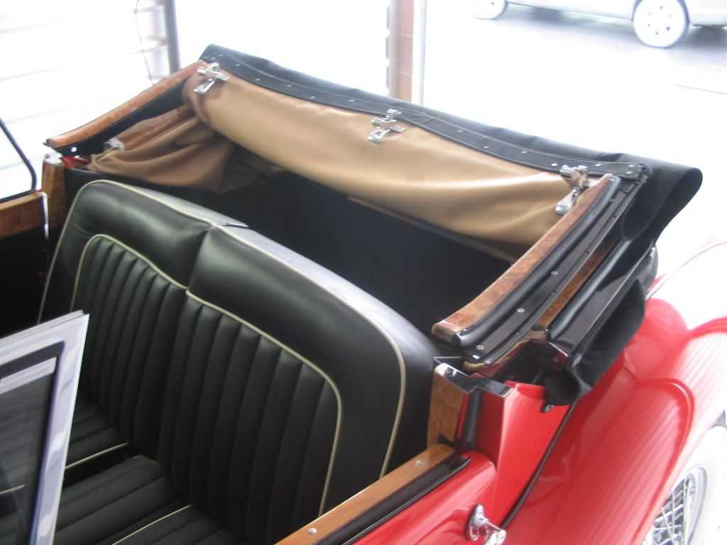

7,998 Posts
Re: (Phunkshon)
Mmmm, beautiful. I guess that is one benefit of the XK140 over the XK120 - the convertible has an easy roof, and wind-up windows
On the 120, you have to sort of assemble the roof, and then the windows are soft, and button-snapped to the assembled roof and doors.
