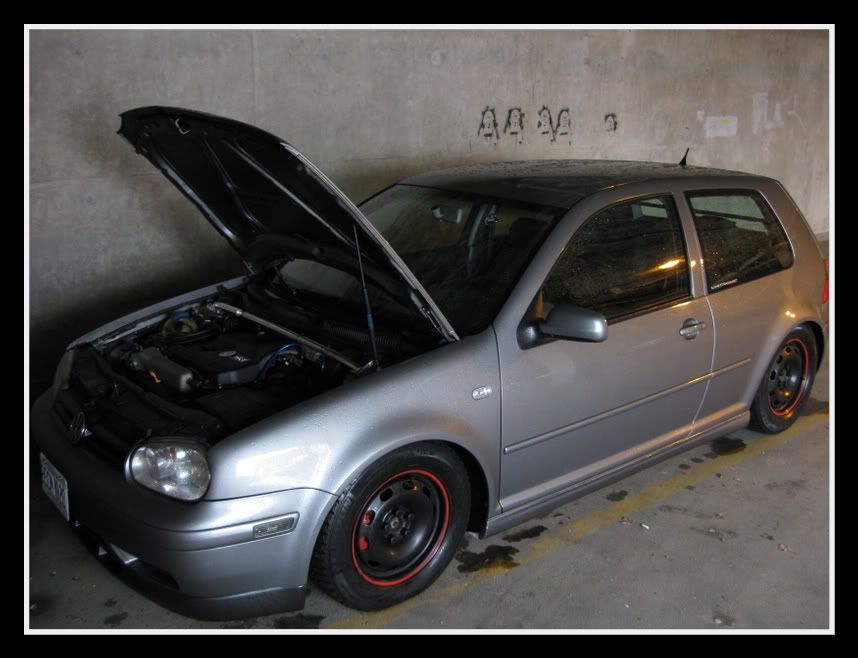

Just the other day I took out my rear perches and was loving the new stance next on the list was wheels....
But that all changed when I was on my way home today on a crappy rainy night. I was coming up to a light to make a left and was slowing down from 60 km/h and the car completely stalls out.... I thought maybe its cause I just did my fuel filter but it turns out I blew my motor or ****ed it bad.... The car seems to try and crank once and sounds like something just spins. I'm at 148,000km and have not done my timing belt and water pump and I believe my timing belt tensioner was making bad noise for the last little while.... My guess is the belt came off i'll have to take a look at it in the morning.... So as of now that car is at my house if it turns out I need a new motor I think it's time I go back to the legendary VR possible 24v six speed swap.... Well lets just hope I get her back on the road ASAP!!!
the OG
17,915 Posts
Re: She will be Missed :( (platinumgrey_1.8T)
sorry to hear....but chances are you just need to pull the head and replace some valves...VERY common problem with the 1.8t's.
Tensioner seizes, timing belt thinks its a jump-rope....and yer done.
I know Lhaki at ESS has done a bunch of these in the last year.
