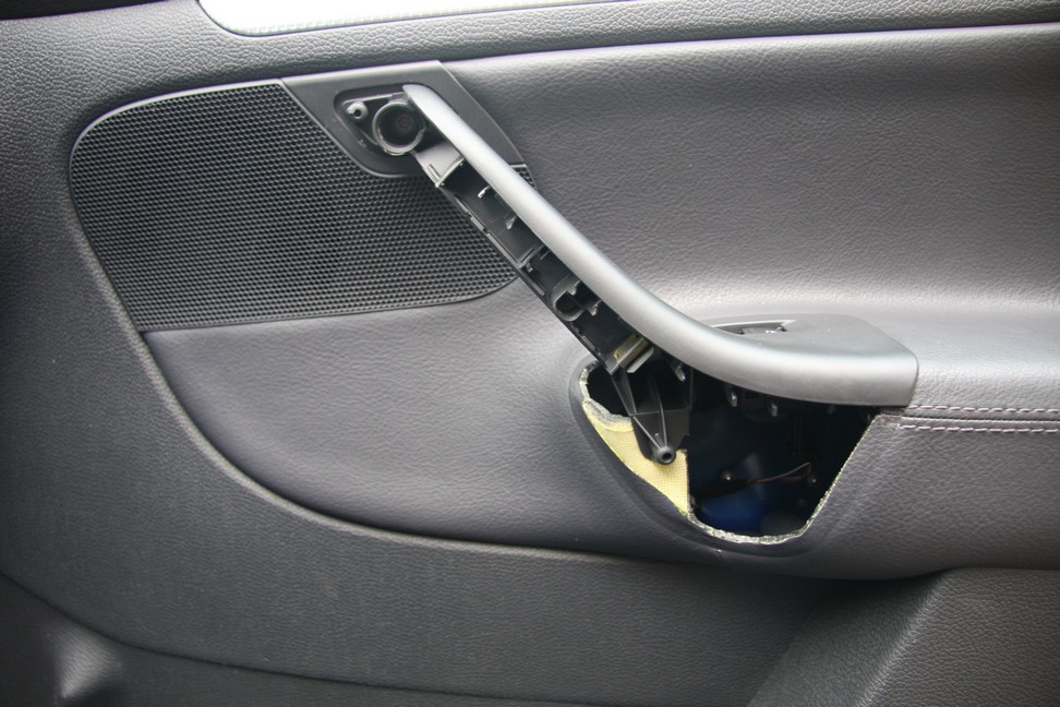

First, I think it's best to start with the passenger side door. Here's a picture of the exposed door with the panel removed for reference.
First thing - make sure you park somewhere that allows you to open the doors completely. You need maximum access to get at the door panel clips that face inward toward the car body!
Now, remove the trim panel on the door handle. The Bentley manual says to pry up on the cover- this is incorrect and it caused me problems. What you want to do is pry outward on the bottom part of the trim panel. Since the manual is wrong and I partially broke this part, I can't say for sure what exactly I did to get it off, but here's a picture anyway:
Behind this trim panel are two T30 Torx screws. One is near the top, the other near the bottom. Remove them.
There is one T25 Torx screw on the side of the door panel near the tweeter. Take this out.
Along the bottom of the door panel, there are three T25 Torx screws to remove. They are angled upward.
