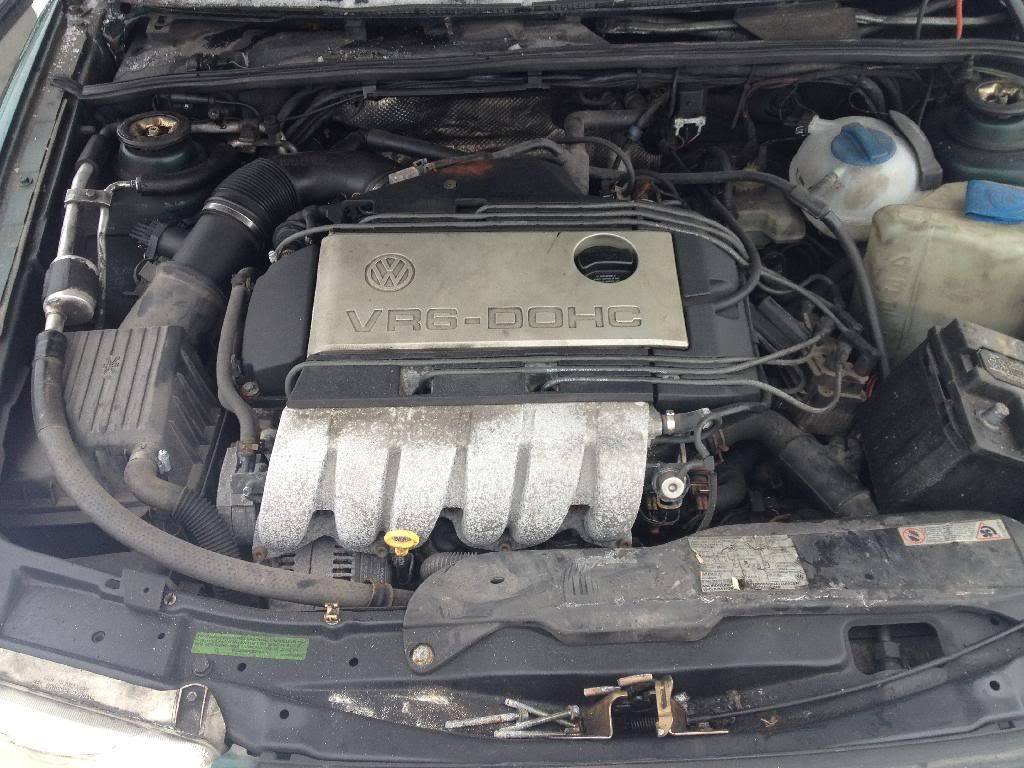

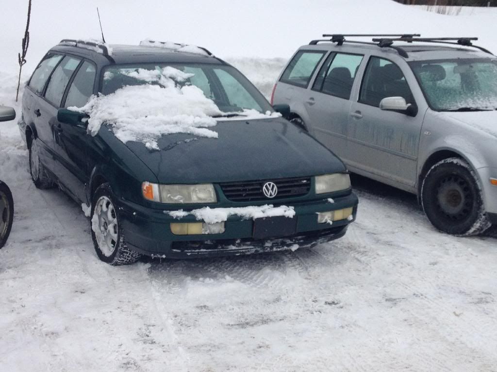

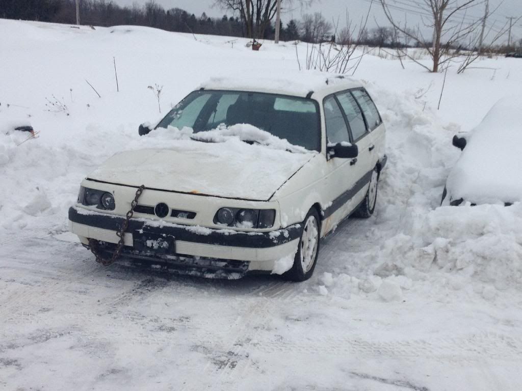

So this year for SOWO I'm building a b4 wagon , it's originally from California . Super clean by Canadian standards . It's an auto so that's gotta go. I'll be harvesting all the running gear from a b3 vr syncro I built around 8yrs ago. In the last two weeks I've dug them both out of the snow with help from a friend , and pulled both motor/trans set ups . I know it's nothing new in terms of swaps but it'll break up the sea of mk5/6's slammed on air with big wheels that all look the same except for different colours . Anyway , on with pics

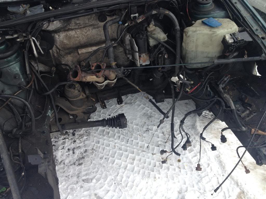

Tonight's progress , repacked cv joints , cleaned up and transferred components to the new motor , popped in the BFI motor mounts , ripped out the rest of the syncro set up from the b3 , dropped the vr and syncro trans into the B4. Cleaned up the mess of rust from the b3. Next time I'll work on switching intake to obd1 , installing obd1 motor harness, pulling dash , new heater core, manual pedals and shift box and cables . Gonna work towards being able to have mobile on its own power . Also have to deal with hanger bearing issues on front to rear shaft . The front syncro brg is NLA. So, I've got a couple BMW units I'll be modifying . Should be interesting .
