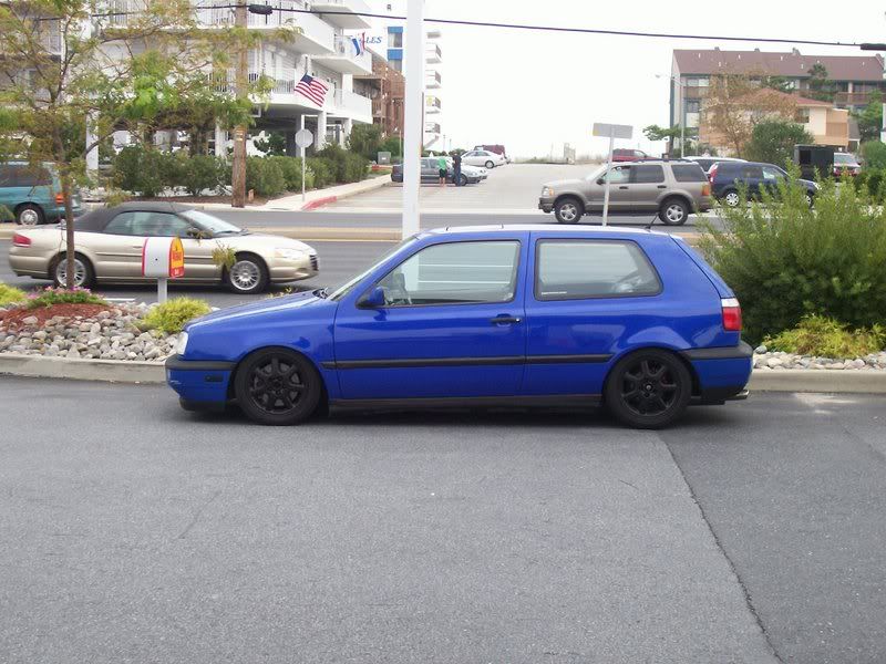

Alright.. so i was driving down the road on thanksgiving, and all a sudden that familiar motorcycle noise started.. check engine light started blinking, and the car was struggling..
so i pull over and pop the hood, and like i expected the spark plug had been shot out of the head, still attached to the wire.. i had no choice but to drive it home (less than 1.5 miles) so i hung the spark plug out of the head and drove it back, tried putting it back in when i got home, but it wouldnt go in , saw that the threads on the spark plug were a LITTLE messed up so i went out and got another spark plug..
tried putting that in and it yeilded me no results.. it wouldnt screw in so now im guessing that the head is screwed up with the threads.. what are my options?
car in question:
thanks guys
