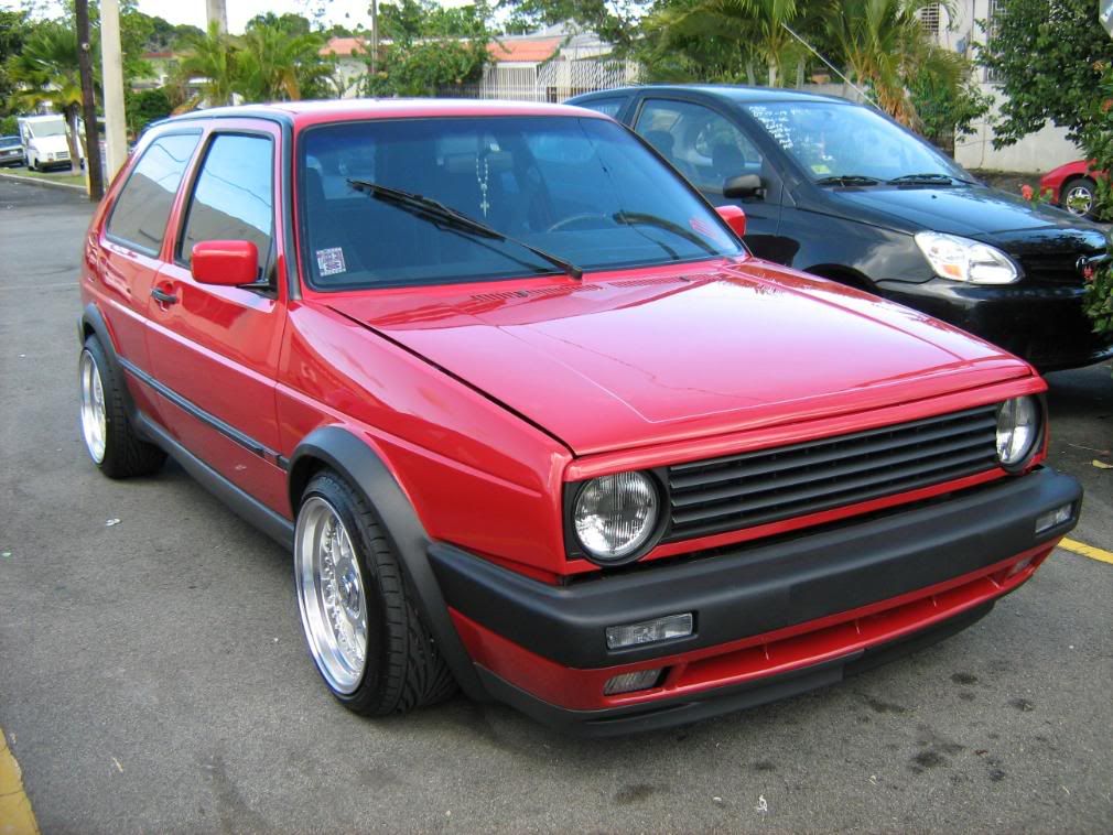

Here is a pic of the Golf

i dont know much about turbo'ing 16valve engines, but i f'in love your gti http://****************.com/smile/emthup.gif

i dont know much about turbo'ing 16valve engines, but i f'in love your gli http://****************.com/smile/emthup.gif
must not know much about mk2's either, that's a GTi
