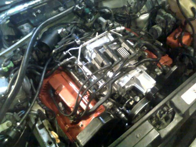

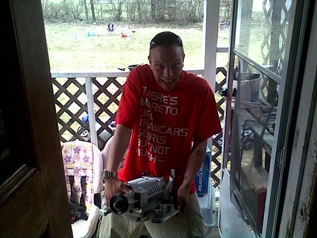

But I wanted more power and had been reading about g2 supercharger from pes tuning.
I bought that ****er brand new for $3727.36
And I installed took 6 hours

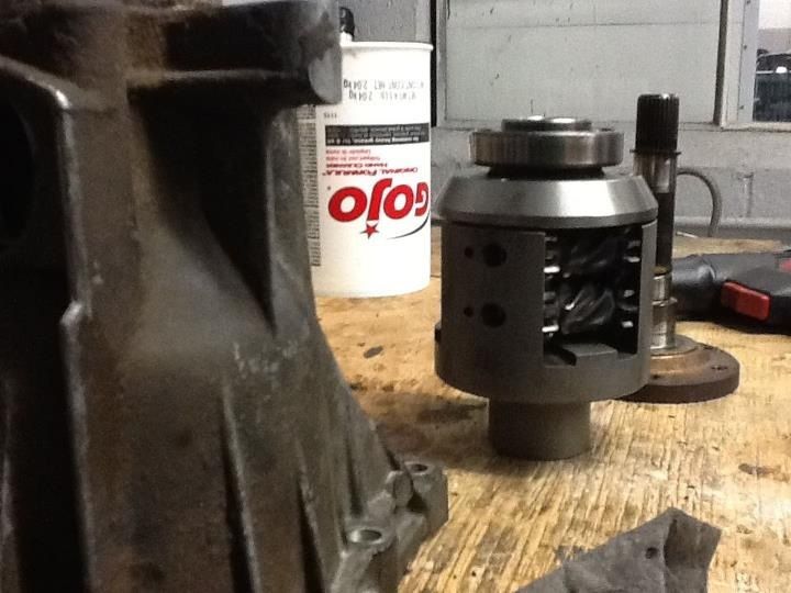

During the 3 months I decided to do a Rwd conversion. So I bought a trans with 80k for 200$.
And I pulled the Torsen off for welding.

Got the bad trans out of car yesterday. When I spin the driveshaft flange is sounds like a pepper mill:facepalm: pulled diff plug and a ton of metal was on the magnet. I know some is expected but this looked like science experiment. I'll break trans down on a rainy day, when It went I swear it felt like I removed 2nd gear from the final drive. Now with out opening trans just hearing it I know I sheared something off final drive :thumbdown: 4000rpm launches :banghead:
