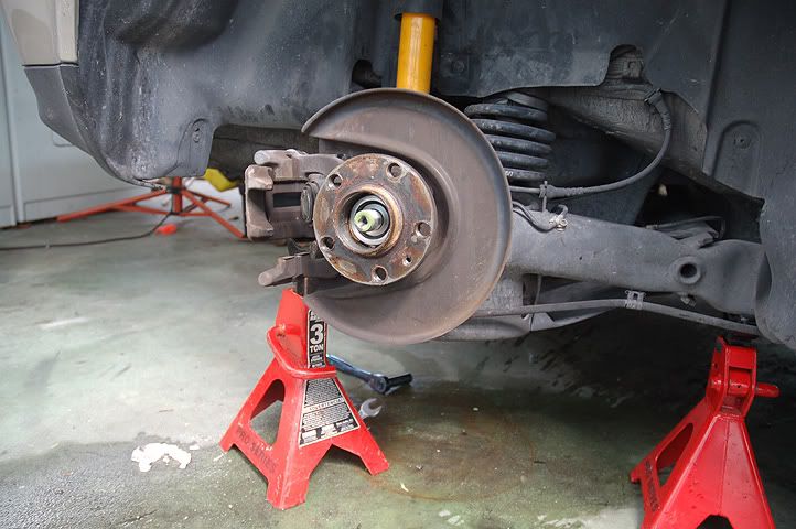

Jack up the rear end of the car, both sides.
Remove the wheel (and any spacers/adapter you might have)
Now you've got the car in the air and the tires off.

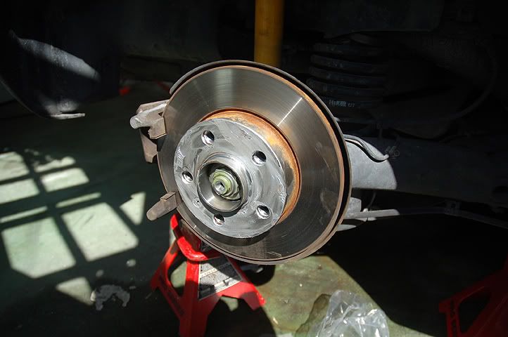

Next thing to do is remove the small Phillips head screw from the brake rotor.
Then remove the caliper bolts, for these use a 15mm open ended wrench and a 13mm socket.
Remove the brake pads and the rotor.
Use a small flathead screwdriver to remove the dust cap in the center of the hub.
Use your 30mm axle nut socket and a breaker bar to remove the axle nut

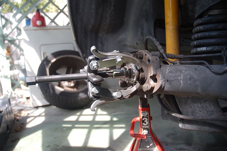

Now you use the puller.
Assemble the puller with the arms that fit best, in my case, the smallest arms.
Use a locking wrench to turn the center bolt of the puller to pull the hub off the stub axle
This will 99.9% leave the inner race and inner seal on the stub axle
When the bearing comes loose, it will surprise you and fall out of the puller, this is what it will look like:

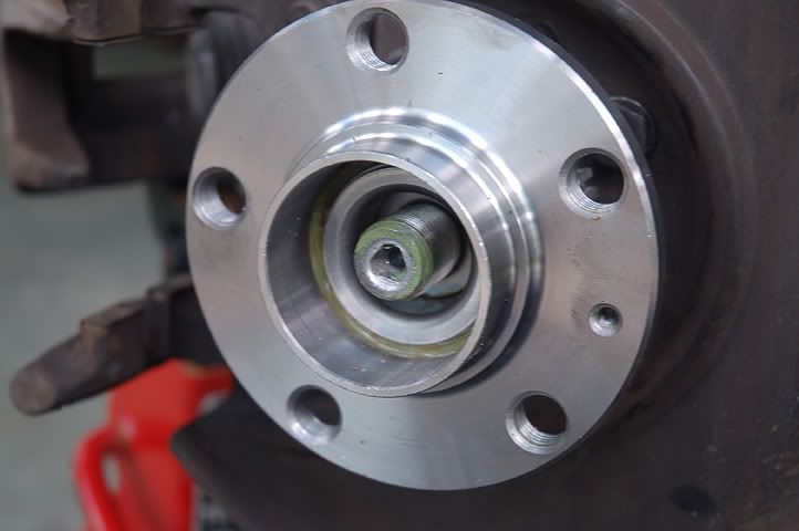

here we have the old hub/bearing vs. the new:
now clean off the stub axle and put some nice anti seize on it
Next, press on the hub, mine went on by a firm hand pressure but you can use a 2x4 and a rubber mallet to knock it on
push the bearing on enough that you can thread the old axle nut on
tighten the axle nut down to set the new bearing and hub into place
then un-thread that axle nut and put on the new one.
