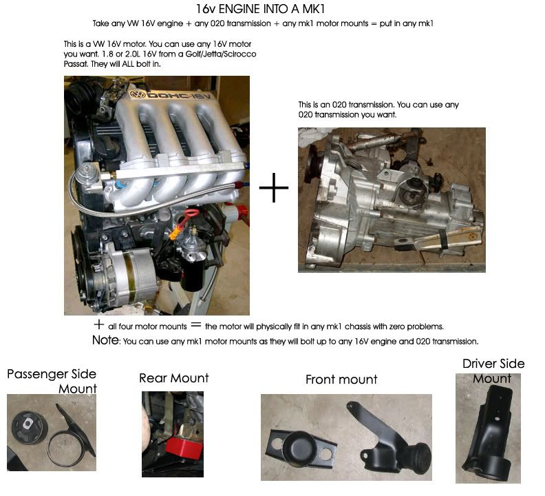

Welcome to the A1 16V post. Below you will find helpful links, websites, owners and diagrams in bold. Please IM me if you currently own an A1 16V so that I may add you to the list of owners. Good luck...
LINKS:
Might as well put this all in one place...

How the motor physically bolts in. For the record....You can use any mk1 motor mounts you want. They can come from any rabbit, cabriolet, jetta 1, scirocco 1 and 2, etc. They all bolt up to any 16V and any 020 no problem.
FOR THE EXHAUST YOU CAN ONLY USE A SCIROCCO EXHAUST MANIFOLD AND DOWNPIPE OR A SUITABLE SUBSTITUTE...FOR EXAMPLE, A HEADER MEANT FOR A 16V SCIROCCO OR A SCIROCCO EXHAUST MANIFOLD AND TTT DOWNPIPE. YOU CAN NOT USE MK2 GOLF/JETTA EXHAUST MANIFOLDS OR DOWNPIPES.
