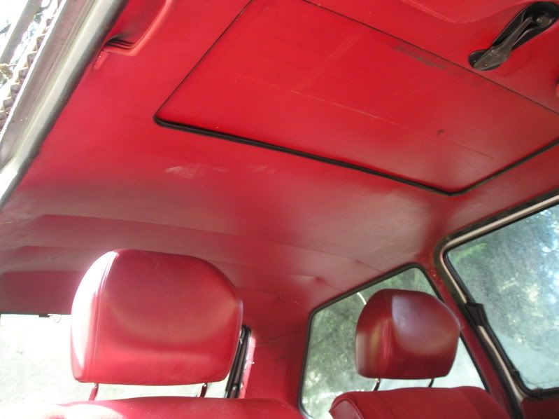

Ive wanted this car for a while now and its basically mine now, though its still not at my house yet. Regardless, I already have a motor that Im building for this thing, already have most of the suspension, I just need some more parts and once I have enough time to finish it all, this will be my race car. The deerkiller, roof rack and lifted suspension all are coming off and are for sale. PM me if you want any, prices will be stupid cheap because I dont need them and I could use some more parts ... also has a sweet red headliner that will be coming out if someone gives me money for it :)
