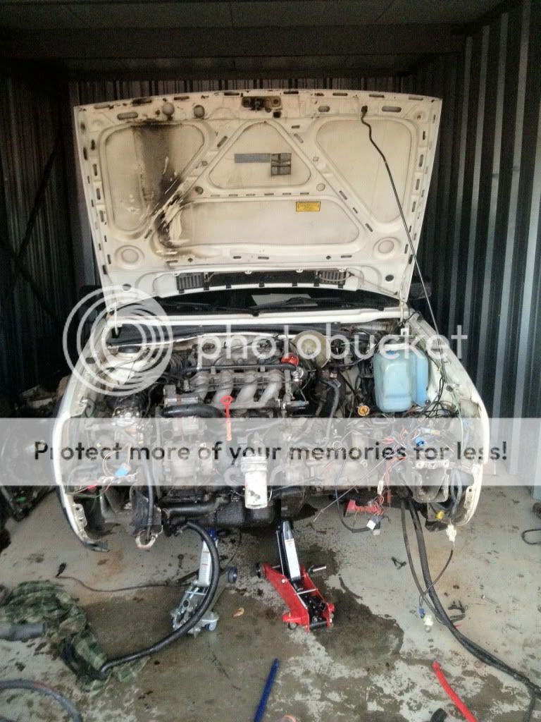

Little update today, I removed the engine wiring harness that goes to the back of the fuse box and cleaned up the engine bay. I plan on doing a semi shaved bay and can't decide wether to paint the nay black or white. On to the pics
Do the vr and 16v share the same fuse box? And does anyone know a diagram showing what vr6 connectors go where on the fuse box? mine were not labeled.
Thanks:thumbup:

It is all plug and play in a CE2 car, which yours is.
The 3 main connector are F, G1, & G2. Then w/o1 for the VSS & injector power from z1 or the 30/30b jump.
