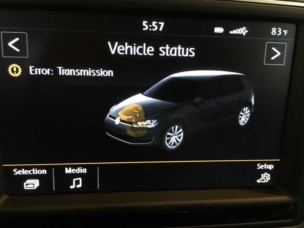

Hi All,
I keep on getting the below "Transmission Error" message from time to time in my Mk7. Sometimes while driving or right after take off. The message disappears by its own, or if I put the car back into P, or if I restart the car. I read on another thread/forum that this does not leave a trace in the log and hence, the root cause is hard to identify when taking the car back to the dealer. Anyone else who experienced this and found a solution?

Thanks for the feedback. One advice I read was to drive directly to the dealership once the error message appears and have it diagnosed right away. If this happens in the morning I might actually do that.

Got the error message again today but it was at 5pm :mad:
Waiting for it to happen in the morning so that I can drive straight to the dealer :banghead:

Got it again, this time it was more persistent though. I came to a stop at my house, put the transmission into P, the message was gone. Then put it into D, message is there again, put it back to P, message gone. I shot a video of the whole thing to show it to the dealer.

Regarding the battery, I will have it checked. On the other hand, I did my own check and read 12.65 Volts. My wife's Tiguan has a newer battery and hers is at 12.65 Volts as well. Anyway, I will have it checked as well. Thanks for the feedback.

Thanks for all the feedback. I took the car this morning to the dealer and was told that it is most likely a faulty shifter. They could not finish the job today and I will get the car most likely tomorrow. I will post an update when I get the car back.

Sorry for the late update:
It turns out that my car's selector lever assembly had to be replaced. It was covered all under warranty. I'll keep monitoring this and keep my fingers crossed that the error message does not appear again.
