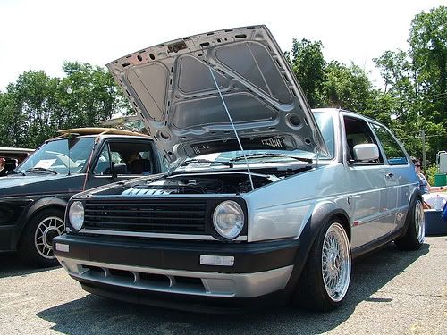

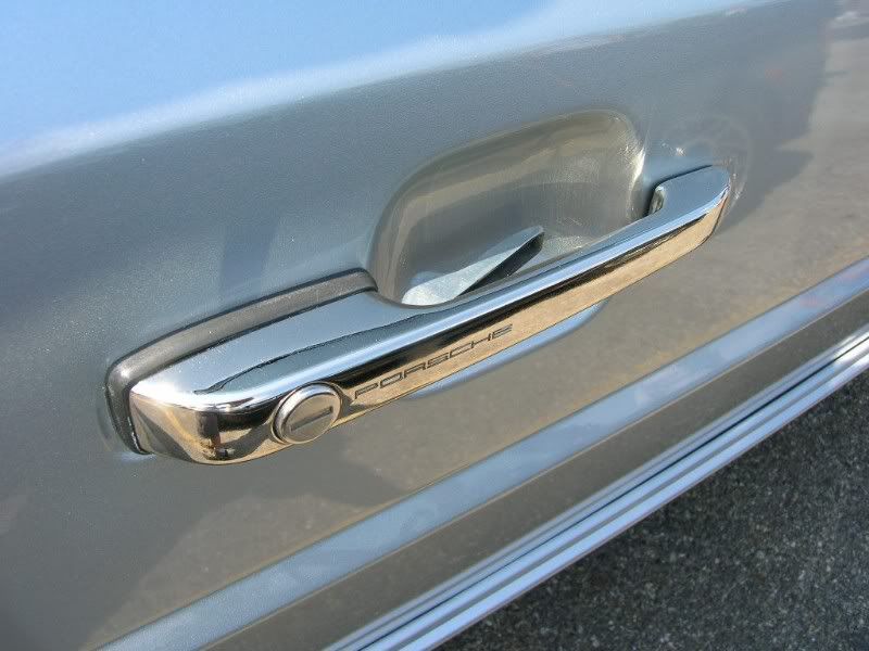

Ehh.. have not posted any new pics in awhile. Over the winter ditched VR front spoiler in favor of 16v, finally started fitting the Porsche handles I have been setting on for over two years, relayed the headlights, new stainless steel buttonhead fender bolts, redline goods brake boot, new speakers, all new bumper clips ect... nothing major this year, hopefully next year.

you need the thin gasket for the small end of the handles. A Porsche dealer should still have them.
You can make the lock cylinders sit flush but you have to orient them vertically if you're using vw lock cylinders. If you use Porsche ones they'll sit flush horizontally but you have to rekey them...no biggie. The reason is because the notch in the lock cylinders is in a different spot on the cylinders between the VW and Porsche and on the handles themselves the cut out arched area is different as well.

Glad to see you still check out the threads in here Shawn. I was actaully going to send you a IM to find out how you got your cylinders to sit flush. Never even paid any attention to your cylinder sitting vertically in there. Yea I still need to pick up the gasket for the other end.

Got my lock cylinders to sit pretty much flush as well...
