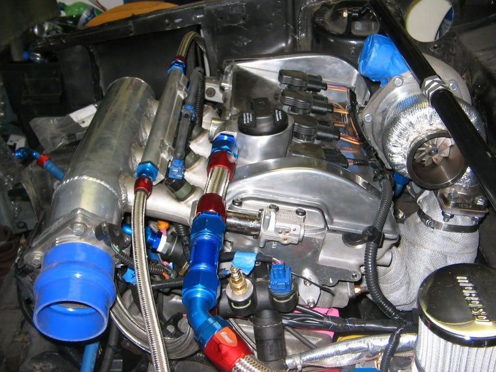

make your own you pansy. or summit has the DEI one for $154. this guy used the kit listed below.... and his turned out fine i think. i have seen it in person, and it looks just fine.

Isn't it dicey to wrap a tubular manifold? I'm assuming it is since the only topmount cast I've seen is the SPA, though I thought that was for a long. setup...BTW, thanks for the blanket kit link http://****************.com/smile/emthup.gif

If wrapped too tight the manifold could crack when it expands...I prefer ceramic coating manifolds, exh housings, downpipes, and dump tubes. You can get coating good up to 2200F
