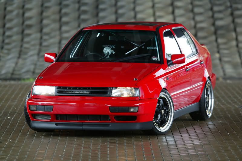

ive seen em around and im diggin em, just dont know if there is a certain type of grill, like a 2 peice? or is just an ordinary painted badgeless grill from good ole ebay like mine?, advice and comments please, thanks http://****************.com/smile/emthup.gif oh and another thing, where do you get that slim boser?!?

thats kind of how they are supposed to be. They look goofy and unfinished when theyre all black

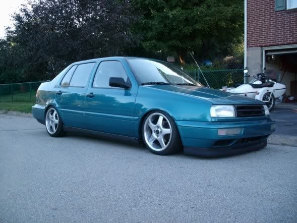

The green car is mine. I made the grill out of two OEM grills. I cut the emblem out of the first one, then bonded in pieces of the second one using a soldering iron (plastic welding) and Fusor 153. The ebay ones are one piece and can be painted to match, but I prefer the look of a true two piece. As said above, the lower strip is metal and clips into a plastic grill. I bought my OEM grill from Oldskool Industries
