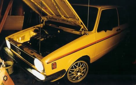

Lastly for those of you who don't know my car...
