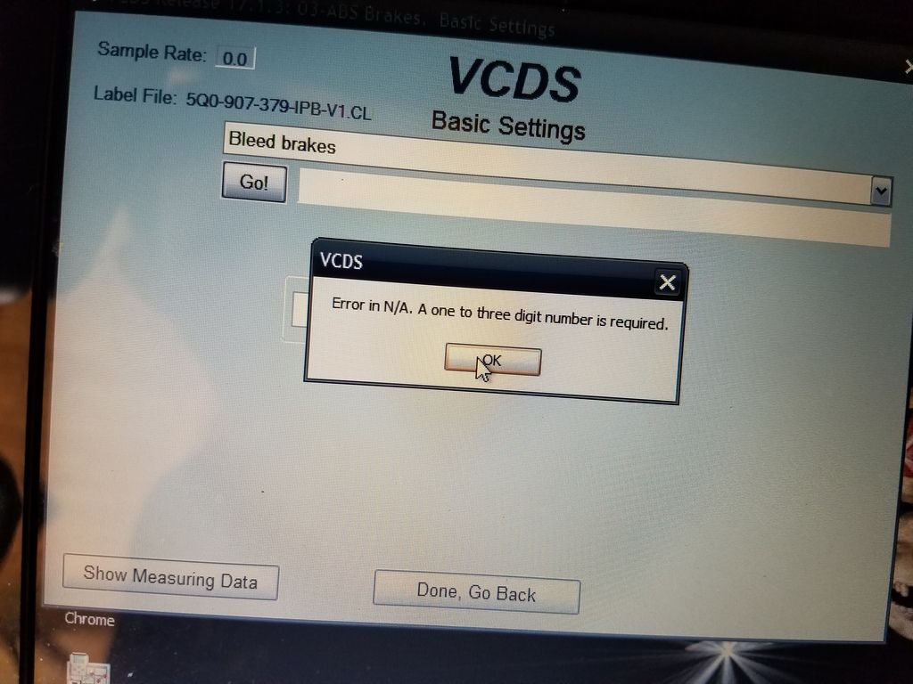

I attempted to do a complete VCDS brake bleed on a 2015 Audi S3 I am rebuilding (needs it because one of the calipers broke during the accident and pedal is still soft after standard bleed).
When I clicked start/go for options brake bleed AND fill & bleed I got the same message:
When I go into the security options, and in general, no bubble pops up telling me what this code might be, even though it has on previous, older cars I've done this job with. Does anyone have any insight?
I was able to actuate open the calipers and close them, but that is it; I think there is air in the ABS pump causing a soft pedal so I really need to do a VCDS brake bleed. Thanks in advance.

Please explain why there is "No Need for a VCDS."
The VCDS is actuating the ABS pump. In my case, the ABS pump has run dry because the car was in an accident and it broke one of the calipers.
I did this process on a Jetta GLI that had a brake caliper/line completely ripped off in an accident. The pedal didn't get firm UNTIL the VCDS bleed was done. Again, when there is air in the ABS pump, your pedal will not get firm until a VCDS bleed is done. Someone correct me if I'm wrong.
The procedure that you've outlined is not the same on a 2015 S3. There is a much longer menu with several other options. The procedure DID match that of my 2013 Jetta GLI.

Ok I'm back. I've pressure bled done everything, it doesn't work, this process needs to be done. The workshop manual I have even says if the pump runs dry you'll need to perform this. That version of VCDS that they want me to use isn't compatible with my cable.
This video is what my VCDS software is showing me
