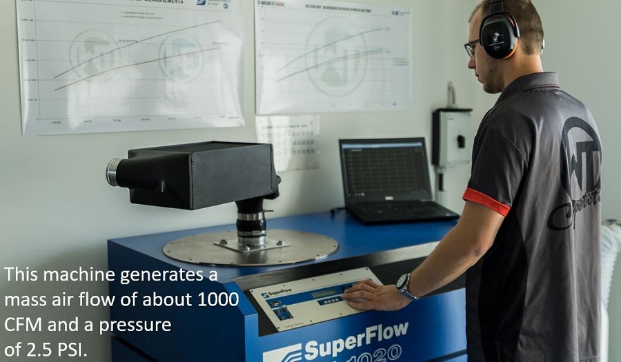

When Wagner Tuning started to have interest in the intercooler market, we decided to develop an intercooler for specific vehicles and design it to perform, removing all bottlenecks that would cause restriction. We produced an intercooler that works in conjunction with all other cooling elements of the vehicle, like radiators and A/C condensers. We also increased the size of the intercooler compared to the OEM intercooler, increasing the amount of air volume and facial cooling surface. Development is what we do!

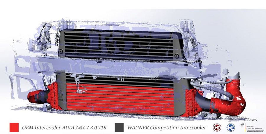

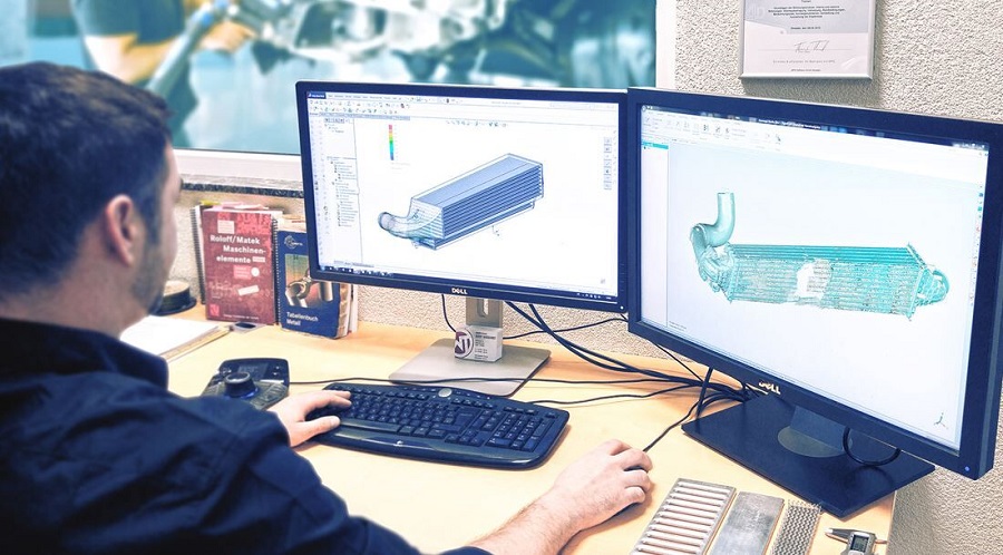

]HOW DOES A WAGNER TUNING INTERCOOLER GO FROM A CONCEPT TO A COMPLETED PRODUCT ON A CUSTOMER’S CAR?
First, we research the vehicle and its potential to perform. Most turbo vehicle’s restrictions are the OEM intercoolers not being large enough or efficient enough, so that’s where we start our research and development to design an efficient unit. We 3D scan the location of the factory intercooler and use all the space that is available to be used for a newly developed intercooler unit. After state-of-the-art testing, we produce a prototype and run a true vehicle test. After it has been proven to perform as developed, we start production and supply the market.

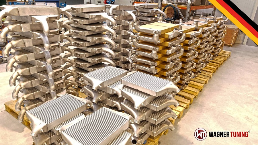

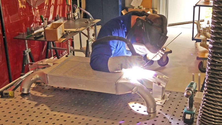

DOES WAGNER HAVE ANY EXCLUSIVE MANUFACTURING PRACTICES?
Wagner Tuning was the first to produce an intercooler using cast aluminum endtanks. This is one our first exclusive ways of producing an intercooler, and soon the competition followed. We also coat our intercoolers to protect them from the elements.
