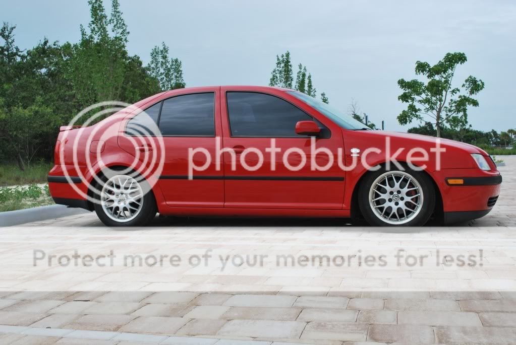

on to the pictures :)
how she sits
kSport Kontrol pro (new version), strut mounts, and bearings
fronts (strut body fully lowered, spring hand tight + one half turn, 12 threads to lower springs, all locking collars are in place. Threads coated in never-seez)
fronts compared to stock
rears
and here goes nothing :D
passenger
driver
