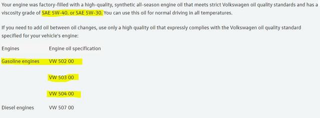

My 1.4t (a 2017) engine requires the use of 5w30 or 5w40 weight oil that meets VW 502, VW 503 or VW 504 specifications.

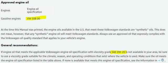

The 2019 Jetta with a 1.4t requires the use of a 0w20 weight oil that meets VW 508 specifications.

FROM 2017 OWNER'S MANUAL
FROM 2019 OWNER'S MANUAL
