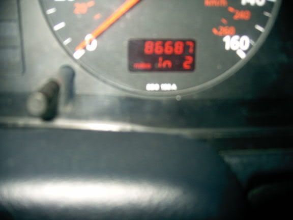

What warning message/code is this?????
Ok I have had this on the car since I got it is it good or bad ????
It says Miles in 2.....
what the heck is that all about??? And how can I get it removed..
THANKS
Modified by buffdaddy at 12:34 PM 9-13-2005
22,684 Posts
Re: What warning message/code is this????? (buffdaddy)
Read through this...
http://tech.bentleypublishers....art=0
and try this:
push in and hold the trip reset button while the car is off, then turn the car on, it'll display service oil.
pull out the other button (the one on the left that changes the clock) until oil changes to ---
push in the trip reset again, it'll then change to service insp.
pull out the other button again until it says ---
