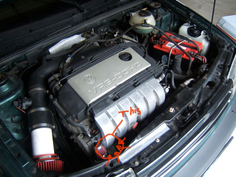

where is the alternator for the 1995 GTI VR6????
1530 Views 34 Replies 21 Participants Last post by  vwishndaetr
1 - 20 of 35 Posts
Re: where is the alternator for the 1995 GTI VR6???? (IIIGTIVR6)
It's under the transmission. You have to pull the engine to replace it. http://****************.com/smile/emthup.gif
See less See more
^^^^messin with you^^^^
I made this for you.
You can just bearly see it poking out in this picture but i think u get the jist.
thanks for playing!
Modified by MK3dirtyeuro at 7:55 PM 1-11-2009
See less See more
2
edit: nice battery tie down and coolant ... you may want to do something about those.
follow the belt ... it will lead you in the right direction.
Modified by low fuel at 10:07 PM 1-11-2009

go grab a bottle of Prestone and a bottle of G12 or G11 and look at the contents. the green coolant does not contain the corrosion inhibitors that G12 has. it does however contain like 2 or 3 sodium based ingredients. sodium = salt. the green coolant can cause corrosion on the internals of our engines. i have seen this first hand. most of you who run the green prolly don't have any problems because you don't keep it in there long enough. but even if you don't have problems with it, the difference ingredients list alone is enough to make me want to stick with the stock stuff.
