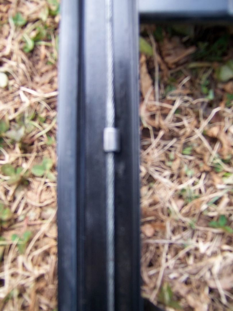

and now to the culpritt.....you can pull the window clamp off the track and look where its broke now. at the top of the picture youll see a small recessed plastic square. at the top of this, there is a plastic quide that guides the cable that is broken off which in return allows the metal piece on the wire to pull out of the recess leaving your window broke due to nothing supporting the clamp.
to fix this is very ghetto but it works. youll need a somewhat strong wire tie and a wire butt connector(pretty thick)...see what i mean ghetto...very thick butt...
... heres what you do. you first thread the wire tie under the cable on the track right above the metal piece thats attached to the wire. and thenbring both ends of the tie through the clamp as you set it back on the track
you then place the butt connector over the whole to bridge the gap and the pull the wire tie as tight as you can
in the process of doing this youll see whats happening...your basically making a wire guide so that the clamp will stay attached to the track.
after doing this, replace everything and your window should work again. just make sure that when you clamp the window back on give it a few test runs to make sure the window is straight and not struggling on the way up. i hope this helps and i hope i can save alot of people from forking over the benjamin at the dealership
