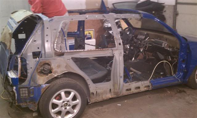

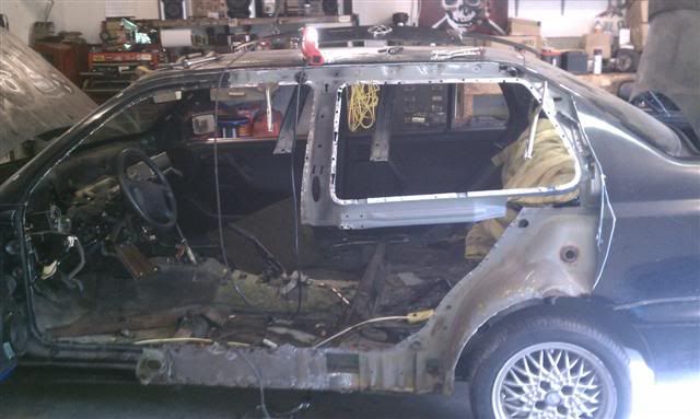

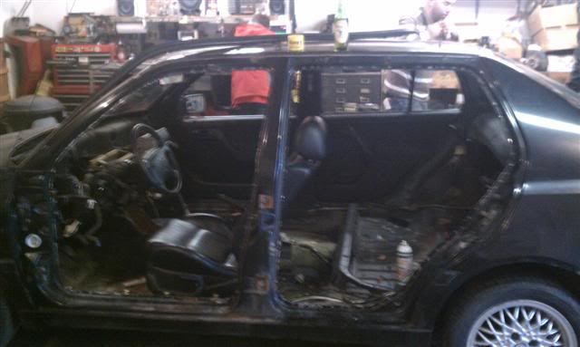

Ahem....well its been awhile. Some pics from where things are at as of today. The goal is paint in the next 3-4 weeks.

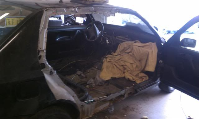

Got some time this weekend to start working on the passenger side. The drivers side inner structure is all welded in.

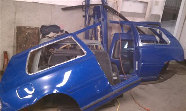

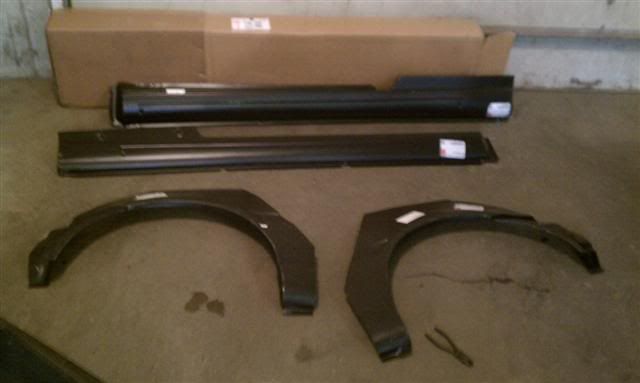

A couple of the pieces I have stashed away for the build

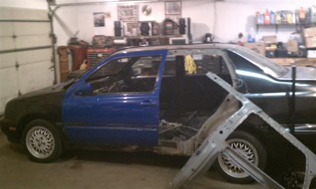

GTI door on

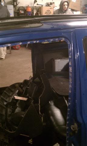

After some trimming and test fitting, the inner structure starts going into place

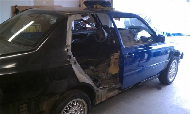

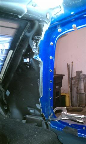

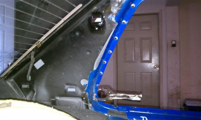

The inner structure is only tacked in place right now. Here are a couple interior shots of where the inner piece from the window meet with the Jetta C pillar:

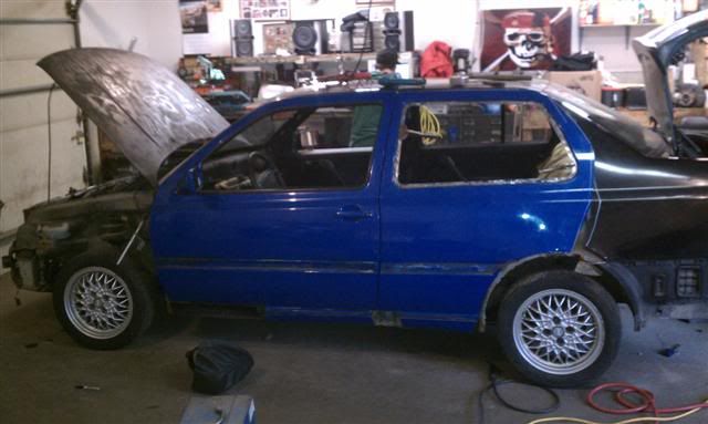

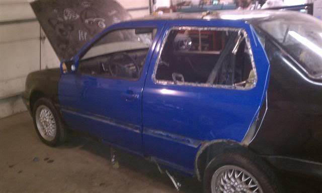

Threw the outer shell on to check the door gap, looks pretty good:

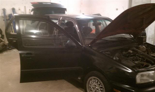

The new build's base is a 1997 TDI, base model. No sun roof, manual windows, etc. I picked up a 97 GTI (rot issues
) but perfect for what I needed. Some pics of the first couple days work:
The odometer on this hoss rolled over, shows 1300ish miles, LOL. It definitely looks like a car that has 301,300 miles, but drives REAL solid.

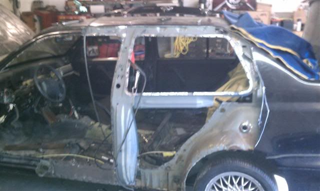

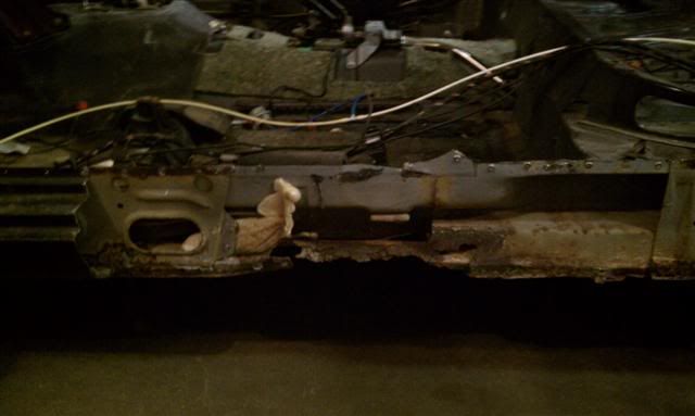

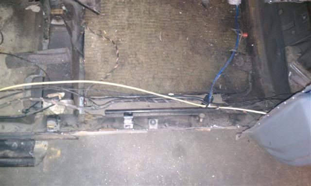

Fixing up the rust issues as I go along. This is where the B pillar used to attach:
All cut out:
