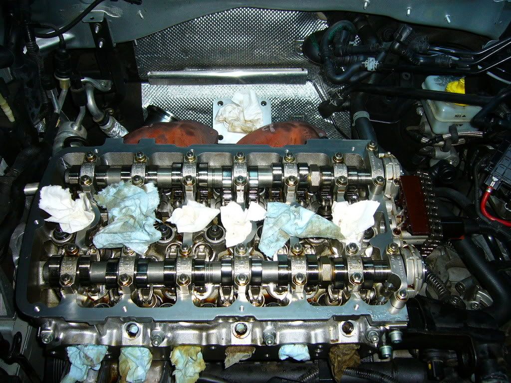

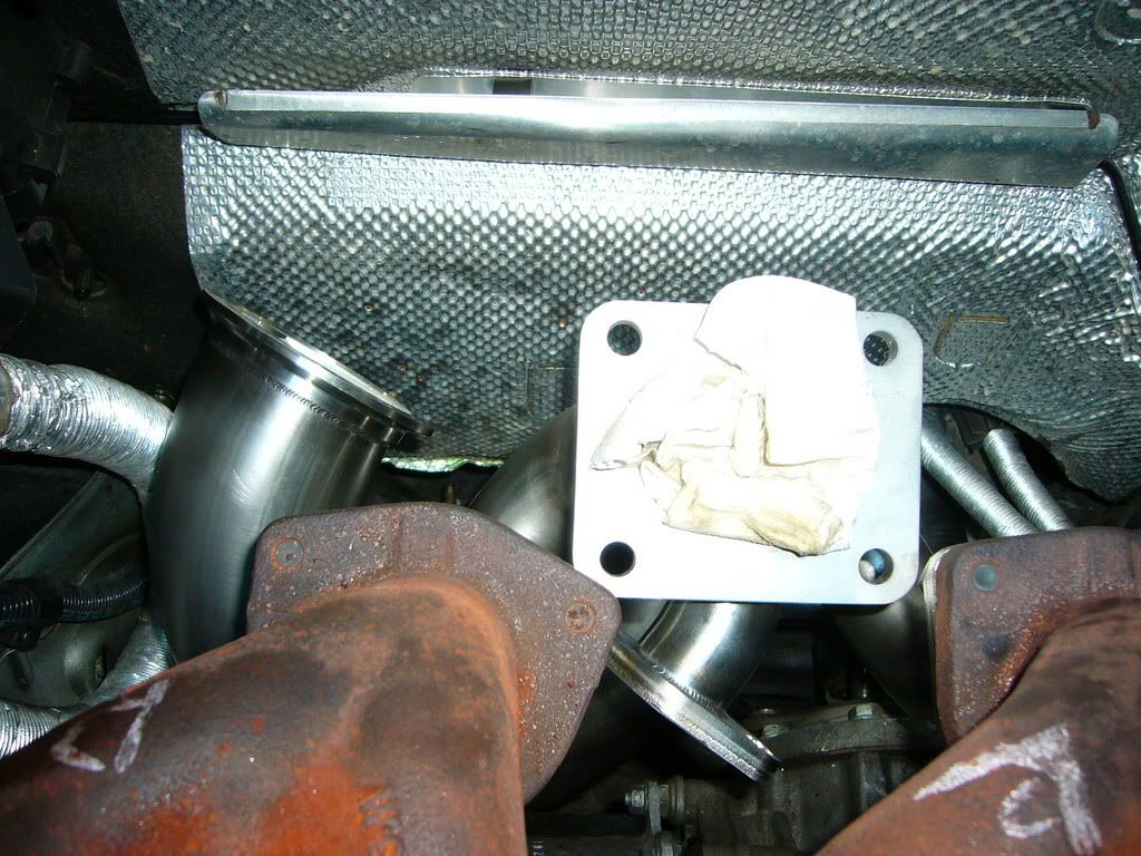

The Installation:
http://www.apextuning.com took care of the build. I have known them for almost 3 years now and I knew they were the guys for the job. They were just as excited as I was about the build. The first plan of attack was to tap the oil pan and put in the new lowered cr spacer, but C2 had told us they could produce the kit quick enough to try and get it done all at once. There were some loose ends due to the rush delivery of the kit, but Chris at C2 was very helpful with making sure we got taken care of. The guys at Apextuning really put an effort into the build. They did run into some snags, but they stuck with it and really pulled it off. Words cannot describe what really has been put into this build. I can say all the aggravation was worth it in the end
